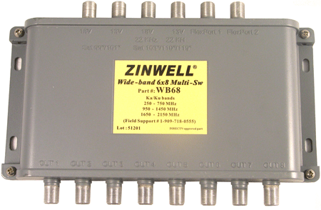

Just wondering if the Zinwell MS6X8WB will work with FTA when connecting multi linear lnb's?.
Supports DIRECTV AT9 wide-band Ka/Ku dish antenna which has a 250 - 2150 MHz output capability. MS6X8WB is also compatible with all other DIRECTV dish antennas so I was wondering if this will be compatible with FTA equipment. I am using a sonicview 4000 at the moment.

It works very well as a 4x8 FTA switch, and is one of the few that passes the full 950-2150 MHz L-band spectrum. The two flexports apparently require special commanding exclusive to DirecTV. I looked around various forums to see what that might be, but couldn't find any useful information.
The usability of the range below 950 MHz is problematic for FTA. Other than DirecTV LNBs and their BBC, I'm not aware of anything else for C/Ku that could take advantage of this. It might be able to diplex an OTA signal, but then you have to keep that switch port powered somehow and have a means of either selecting the correct port for an OTA tuner or diplexing on every input port. There's also the question whether it can pass anything below 250 MHz, where some OTA stations live.

pendragon mentioned the flex ports which are useless for FTA

There are no built-in trunking ports. The best way to get 16 independent outputs would be to put a power passing (both ports) splitter on each of the 4x8 inputs.
