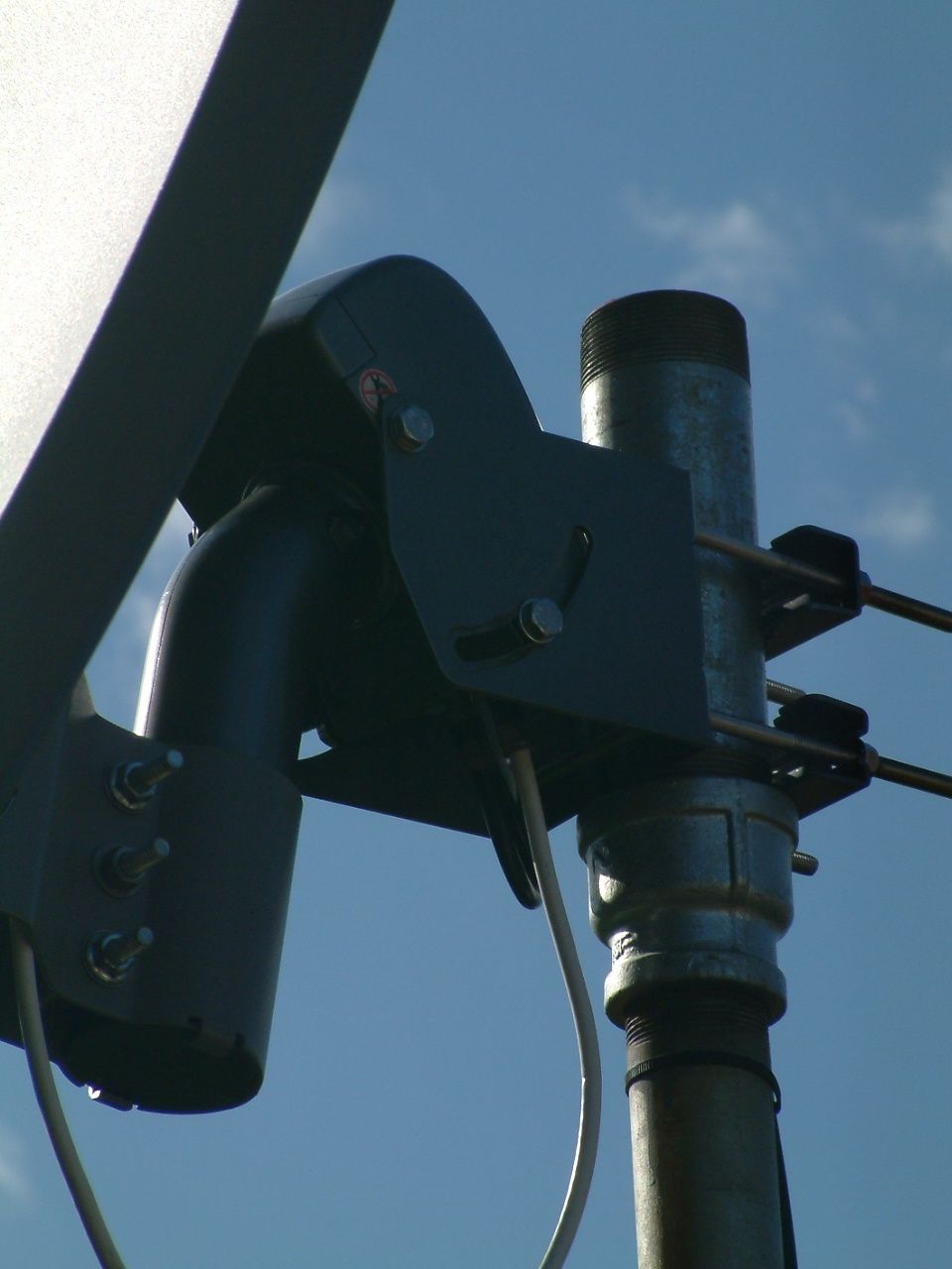

I purchased the Sadoun Powertech HH Mount Motor DG380 DG-380 DiSEqC 1.2 CompatiblePowerTech DG380 from Sadoun on 3/25 and it arrived in 3 days, packed well and arrived without any damage. It is very similar to the SG2100 but with a few differences, mainly a larger Tube to handle a bigger dish and metal gears. I installed this with a 1m Winegard DS-3101 dish (about a 35 lb steel dish) which fit fine on the large diameter tube without problems. I clamped the bracket onto a 2 1/2" diameter pole that was already planted in my back yard and proceeded to remove the tube from the motor assembly (loosened the nut and backed out the hex bolt using an allen wrench (not included with motor). I then attached it to the mounting bracket on the Winegard 1m dish, no problem there, mounted nice and securely. I then attached the motor onto the bracket and locked it at my elevation (41.5 degrees), this is where I got into a little problem, I put the tube back onto the motor, BUT, since someone make a design change from other motors (like the SG2100 and GS120) and there is no way to put the hex bolt back in UNLESS you change the elevation back to the highest setting (~15 degrees), then it slides right in. (to me, this is a design flaw, but that is just me since it would be nice to lock in the elevation before you add the weight of the dish to the motor like the other motors do).

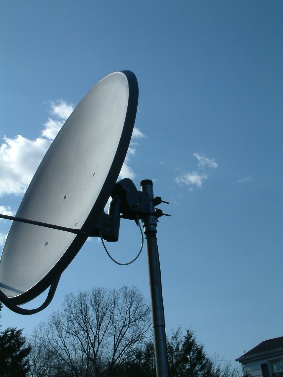

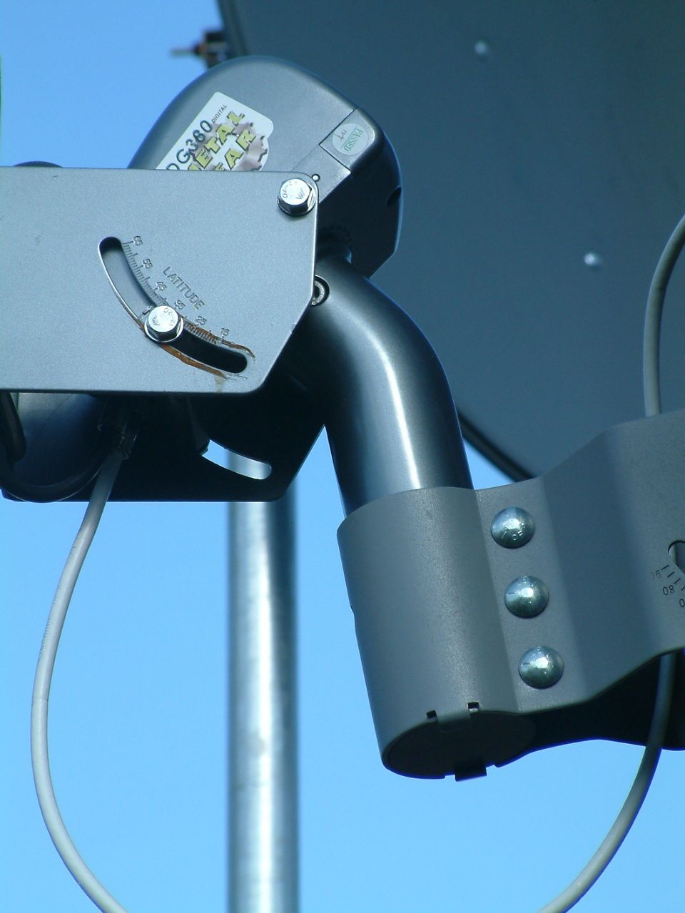

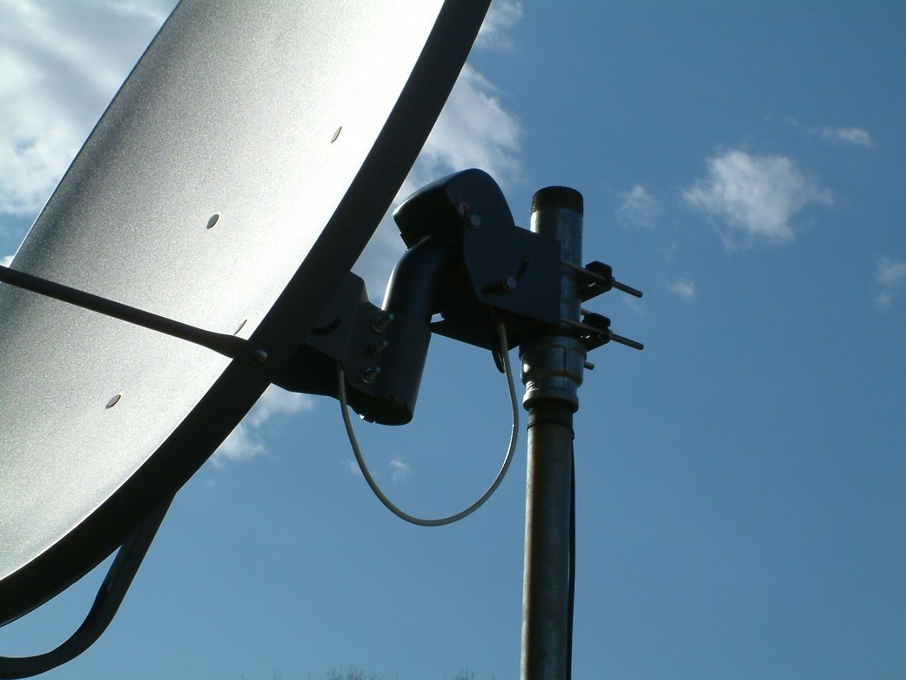

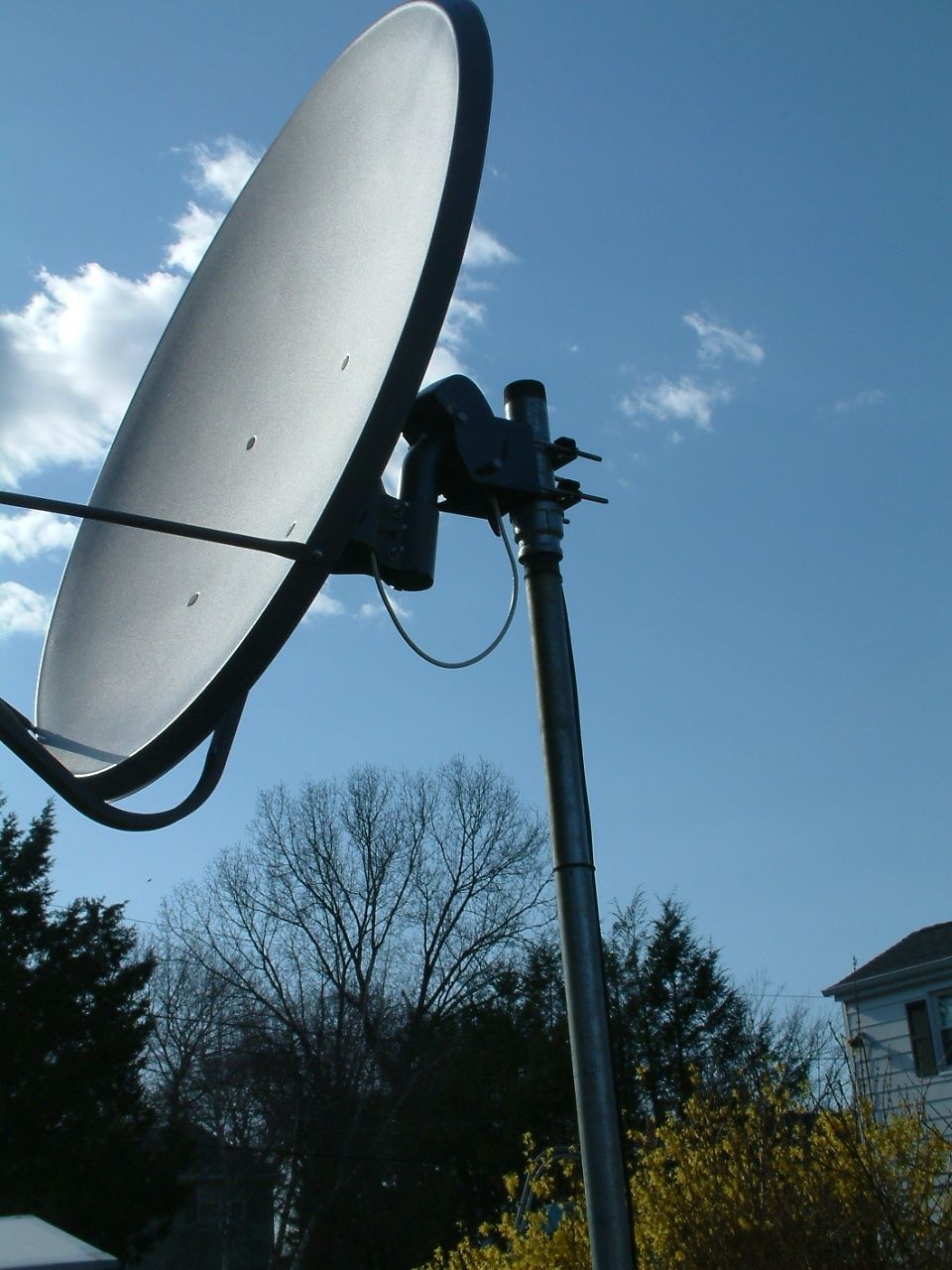

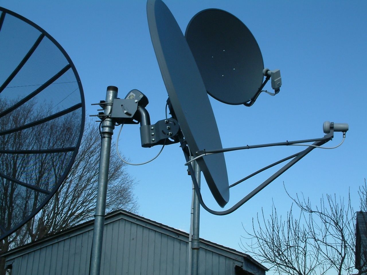

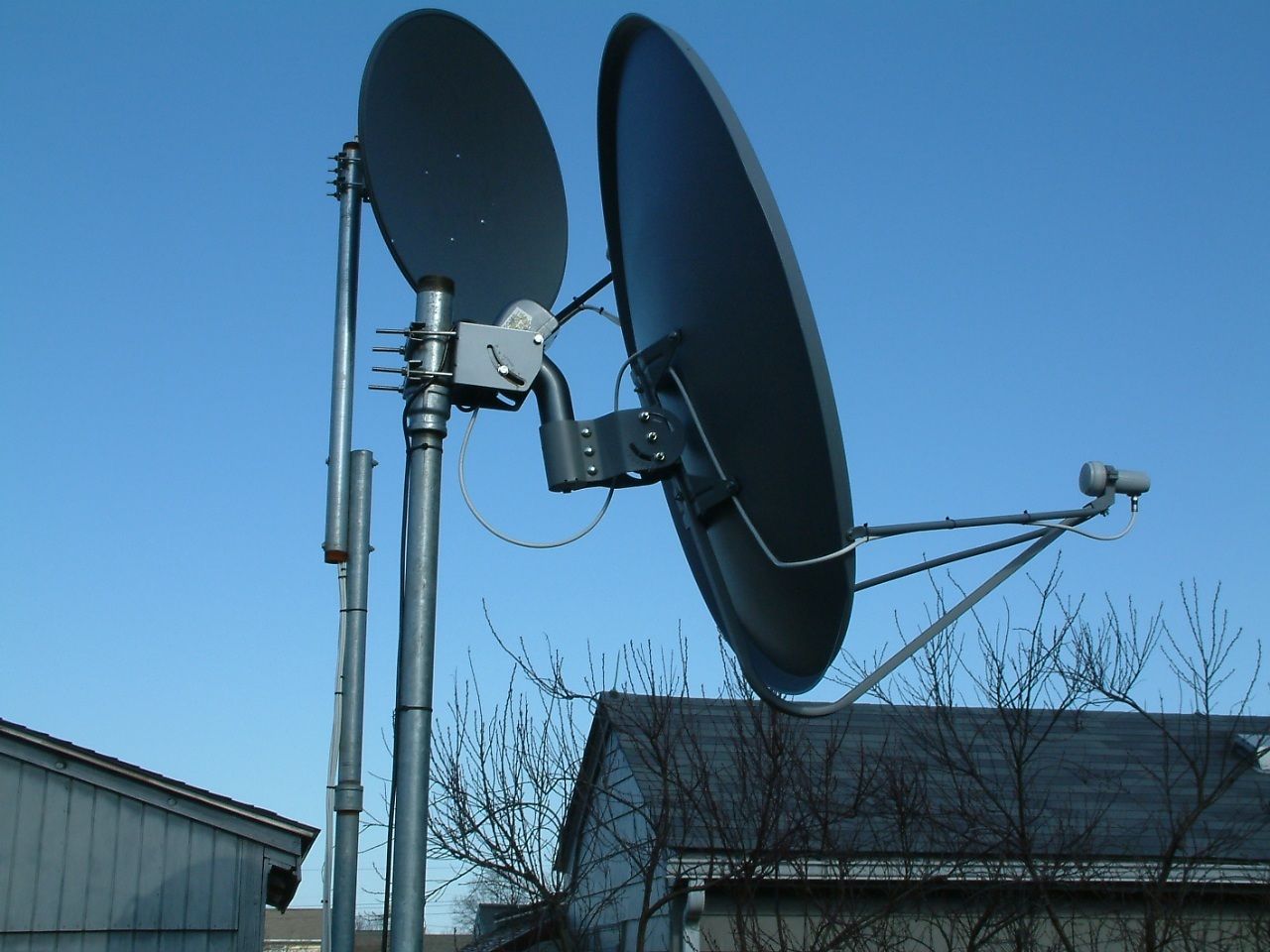

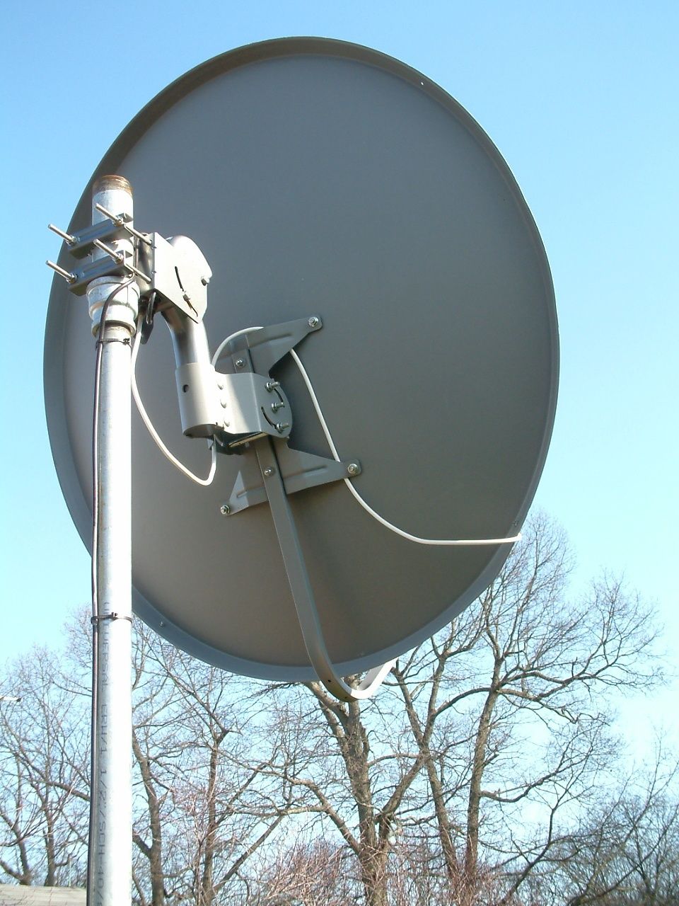

Pictures were requested from another member, so I figured others also wanted them and the weather got better, so here they are. Notice in picture #66 that the bolt could not be reinserted without moving of the elevation adjustment.

Thanks! Yeah, after uploading them, I noticed that too. The camera is a 5yr old camera, a Fuji S602 and highly recommend it to anyone that needs a great camera. The dish is on a 10' mast and I took the pictures from the ground and macro was not on.
Great review and pics, vfrjim. Looks like I'll be getting this motor and a 100cm Fortec Star for my maiden voyage into Ku reception, the info you guys share with everyone here is pure gold, appreciated.
