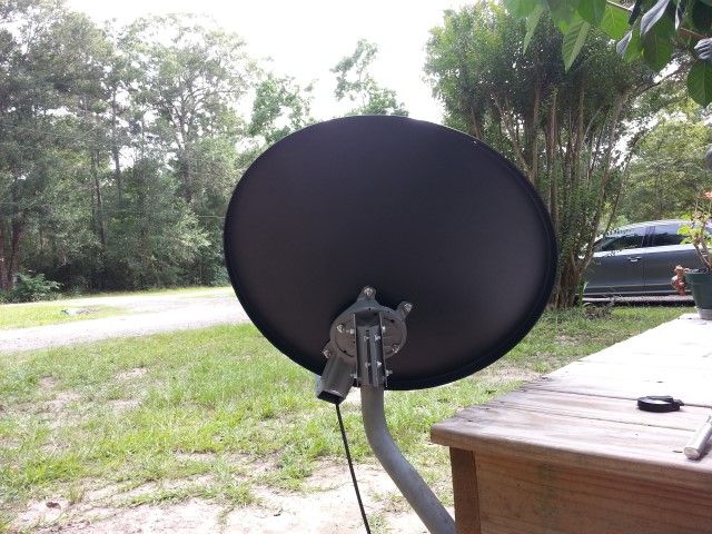

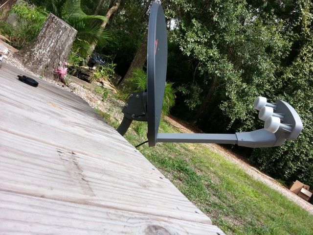

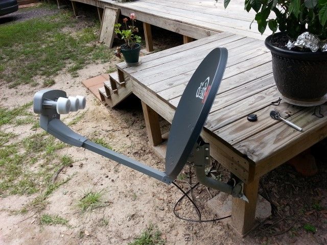

make sure the lmb bracket is assembled correctly there are two holes that the plastic piece slots into
I have seen that not lined up correctly before making it impossible to point the dish
The plastic LNB brace is in the holes on the arm. Here's a couple of pictures.

Not that I think it part of your problem pointing the dish but those leftover nuts and bolts go in the skew-plate ...its not critical but it firms it all up with 4 in there
DVRexpander - Yes the mast is at 90°, learned my lesson on that years ago on my first install. Everything is tight with the exception of where the pole mounts to the mast. It is snug, not tight. Nothing really rocks when I move it. There is a little play but when I stop moving it it goes back to where it should be. About ready to give up!
Hudgreen - No left over parts. Every hole has a bolt and nut in it.
