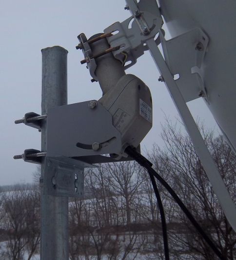

Hi Fuifnummer! I added a bracket below my motor mount to keep it from sliding down the pole when the bolts are loosened. Bought it at home depot ( http://www.homedepot.com/p/YARDGARD-2-3-8-in-Adjustable-Wood-Adapter-328598C/204510284 ) and it works very well.
Also, check out this post for an excellent device one of the members here came up with for adjusting your dish. http://www.satelliteguys.us/xen/posts/3471215/ Hope it helps! Good luck! :)
