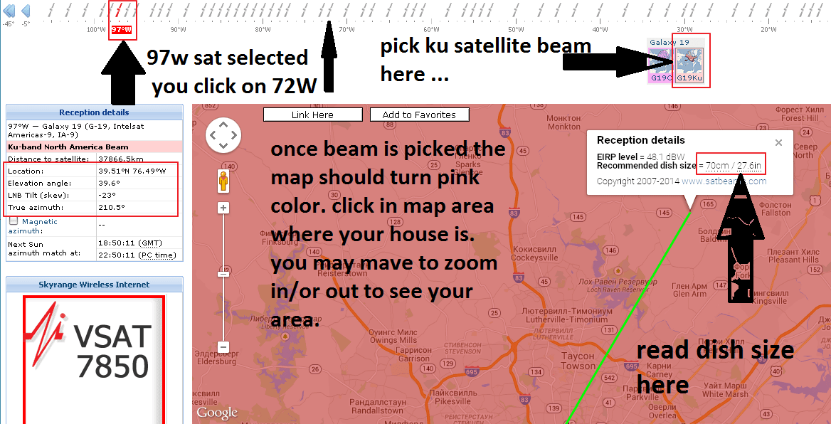

hey bud. I think before we decide on a combo we should decide on what size dish you need. Lets not get ahead of ourselves. below is a recent picture of what satbeams should look like (thanks very much borisov-54 :)) I couldn't show you a picture cause mine isn't working. I've modified the picture to drawn in where to pick the sat & where to pick the sat beam & where to read the dish size.
If satbeams is working for you follow the instructions on the picture below. Then repeat instructions for each sat you want to check dish size. Once you've figured out the dish size report it back here in this thread then we can move forward to pick a combo.
Hope this helps.
How do you get it to show the reception details? All it shows me in the little white box is www.satbeams.com
Actually over on the left side it shows azimuth, elevation, sat location, distance, but it doesn't show anything regarding dish size.
When you zoom in on the map and then click on your location a box should pop up showing EIRP and dish size required.
When I click on the location of my satellite the box that pops up says:
"Copyright 2007-2014 www.satbeams.com" and that is it. There are no recommended sat sizes. If I click on that box, then I get a field to send an email to the satbeams people. I am using Firefox. Maybe something is wrong with my set up.
Now if I use SatStar, utilizing the sats that FTA4PA recommends, the largest suggested dish is 70 cm. Should I go with that or go bigger? For some reason my H2H mount won't allow me to go further east than SES2, and it looks (so far) on C band, the farthest I can go to the W is AMC8 @129W (although I will see if I can get further out there tonight).
That's definitely strange that Satbeams won't work for you, especially if you are using Firefox. I'm currently using Firefox 35.0.1 and all works fine.
