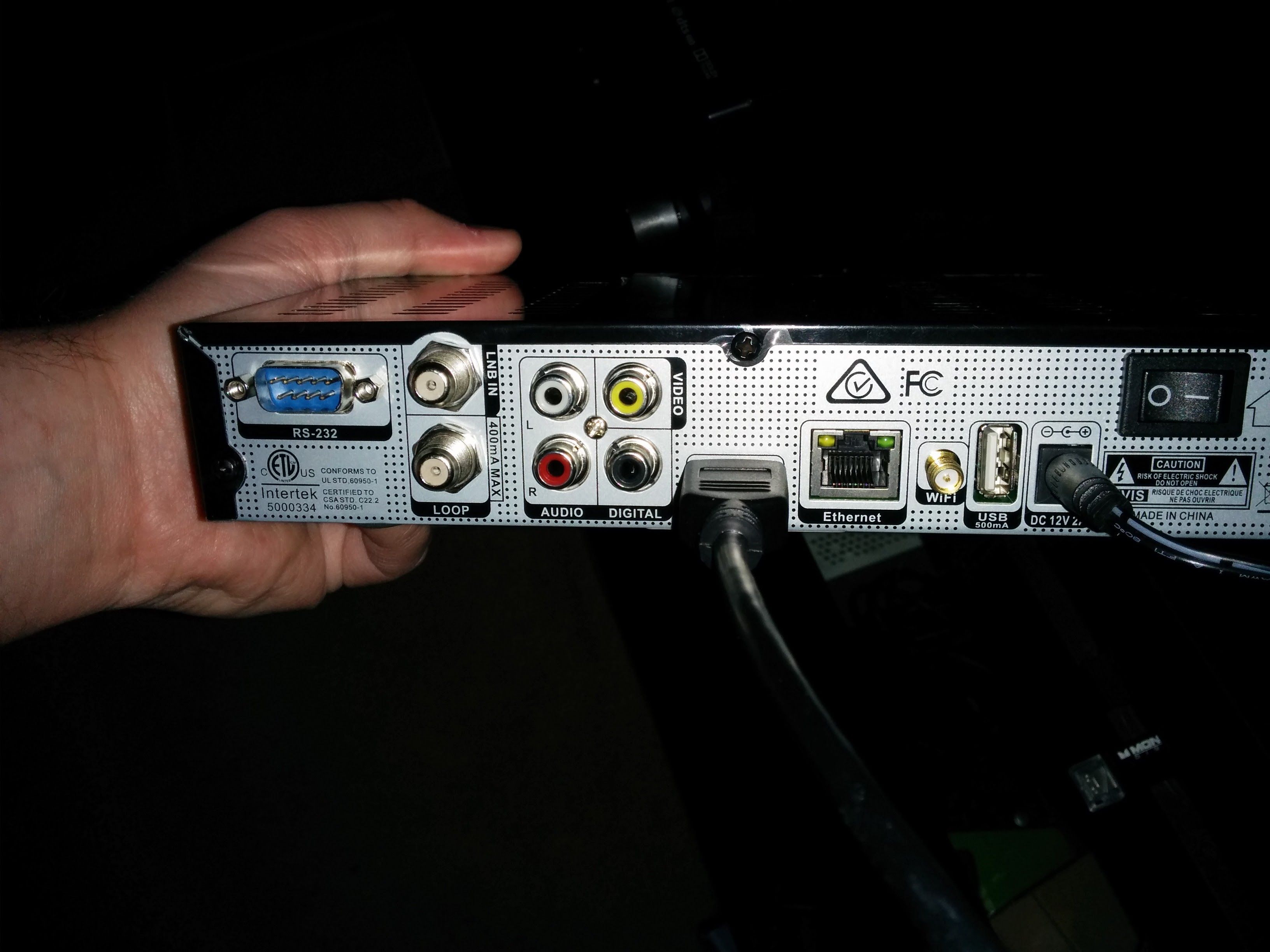

Yes, I am using the power supply that came with the receiver. I tried the power supply from the failed box as well to rule that out. Once the box is booted up and displays the last channel number, it does not respond to any buttons on the front panel or the remote. I've tried restarting it several times, and sometimes now it shows the code "0903" and sticks on the logo screen. Is this one in your database?
I have tried using both Composite and HDMI and get the exact same result.
Everything was working great until I rebooted the first time and it did the automatic update from over the network. The box does respond over the network OK like last time, so if there is anything I can run over telnet for you, or even give you a remote session so you can check that out yourself, that would be fine too.
Here is what is plugged in during the video, just power and HDMI.
Here is a YouTube video of the bootup process.
Could the configuration be corrupted, and it not getting overwritten with the firmware burn? Is there a file I can delete over telnet, and then redo the firmware burn to replace it with a default config?
Breakthrough: I got the box working again this morning! The issue we were seeing was the box would attempt to tune to a channel immediately upon bootup, and when that failed the dvb program became unresponsive. Thus the remote or front panel did not work, however the OS was still running. I managed to get back into the menus again by hitting the power button on the remote rapidly until the "LoAd" was finished and got the box to go to sleep just after bootup. When I then hit the power button again to wake the box, it sprung to life.
Checking the settings, I had put a channel in the "boot program" setting. Apparently if when the box starts up it tries to tune to this channel and if this requires a motor move, the box will not be able to tune into the channel and will just freeze up. I think this is an alternate manifestation of the bug here: http://www.satelliteguys.us/xen/posts/3893172/ Putting the box to sleep upon startup and then bringing it out of sleep gave it a chance to ignore the boot program channel and lock a transponder that the dish was aimed at.
I did a factory reset after getting back into the menus and all is fine now. This is a critical bug, because it causes boxes to be unusable if it happens... at least now there is a workaround.
