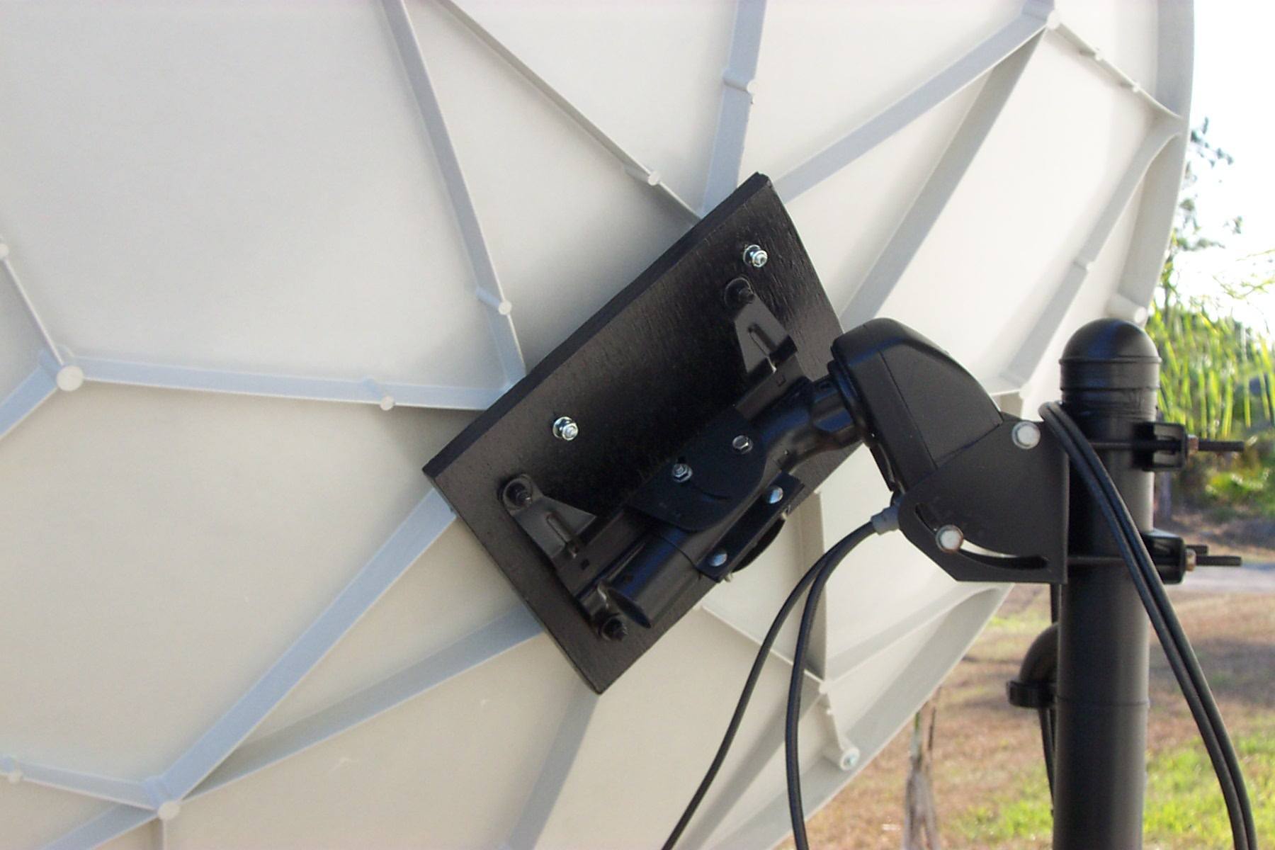

I've been using the same SG2100 motor on my 120cm Channel Master dish now for the past 9 years with no problems.
I started this thread as members repeatedly ask how to motorize a Primestar. There are not many good solutions.
Your solution is somewhat protected and near the ground. While it works, the mechanical integrity of the motor would be tested by any significant wind gust. I certainly wouldn't volunteer to stand underneath of it during a windstorm if it were mounted any higher.
Today's SG2100 motor wouldn't be capable of supporting a 1.2m. The bracket is now paper thin. You probably have one of the good versions like I have before it went cheap.
