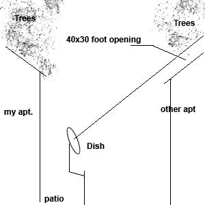

Well, After viewing my area, I don't think the 12 foot pole on the roof would help, as the trees go up another 20 feet higher than that on my roof. There is an area across the way that is clear of branches about 30x40 feet that I am wondering if the signal could get through. I am pretty sure we can screw bolts into the patio, just not the main building. I was thinking of raising it to the level that it could get a signal with the 46 degree angle needed. Will this be enough room? I am confused as to how much open space is needed. Here is a digram of my situation:

http://www.bjup.com/services/bjhomesat/tech_support/obstacle.html
This may help you in determining your location.
At least to clarify the missing of the trees and the other apt. bulding.
You need to check your co ordinates carefully for the system you intend to use in your zip code.
The link above is concerning the installed height of youre dish ...and not ground level.
