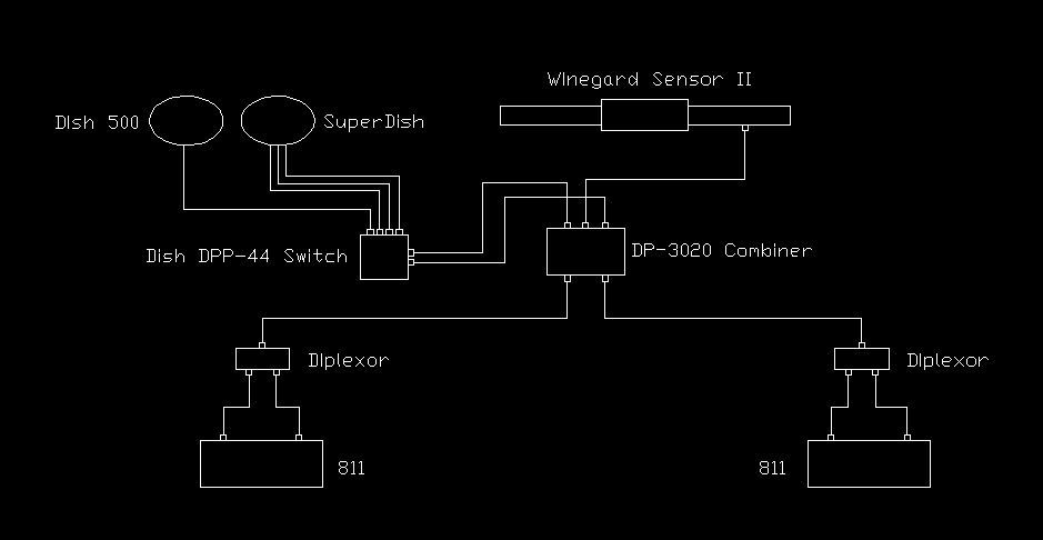

Are you trying to split the OTA signal to multiple TV's? If not run a line from the antenna to the back of the 811 using no diplexors.
My setup, I don't know if it will help, but worth a try. If just one receiver run a single line like Kevin said.
