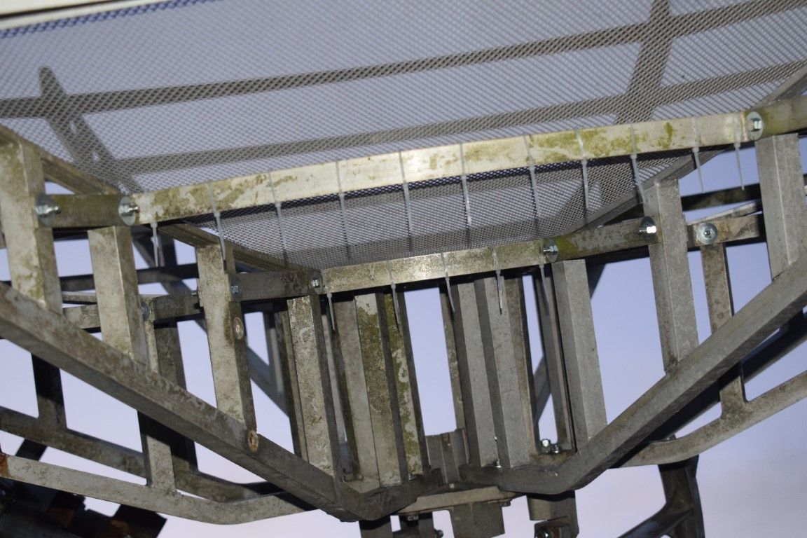

Its not a issue to replace them :), they really pull the mesh tight on the ribs.
Is that some kind of chicken wire you're using for the mesh? I believe I've seen something similar at the local hardware store and I believe those are 1/4" square openings which I believe is good/OK for C-band.
Its the older wire mesh that will do ok for c band and ku if the dish is setup correctly :).
