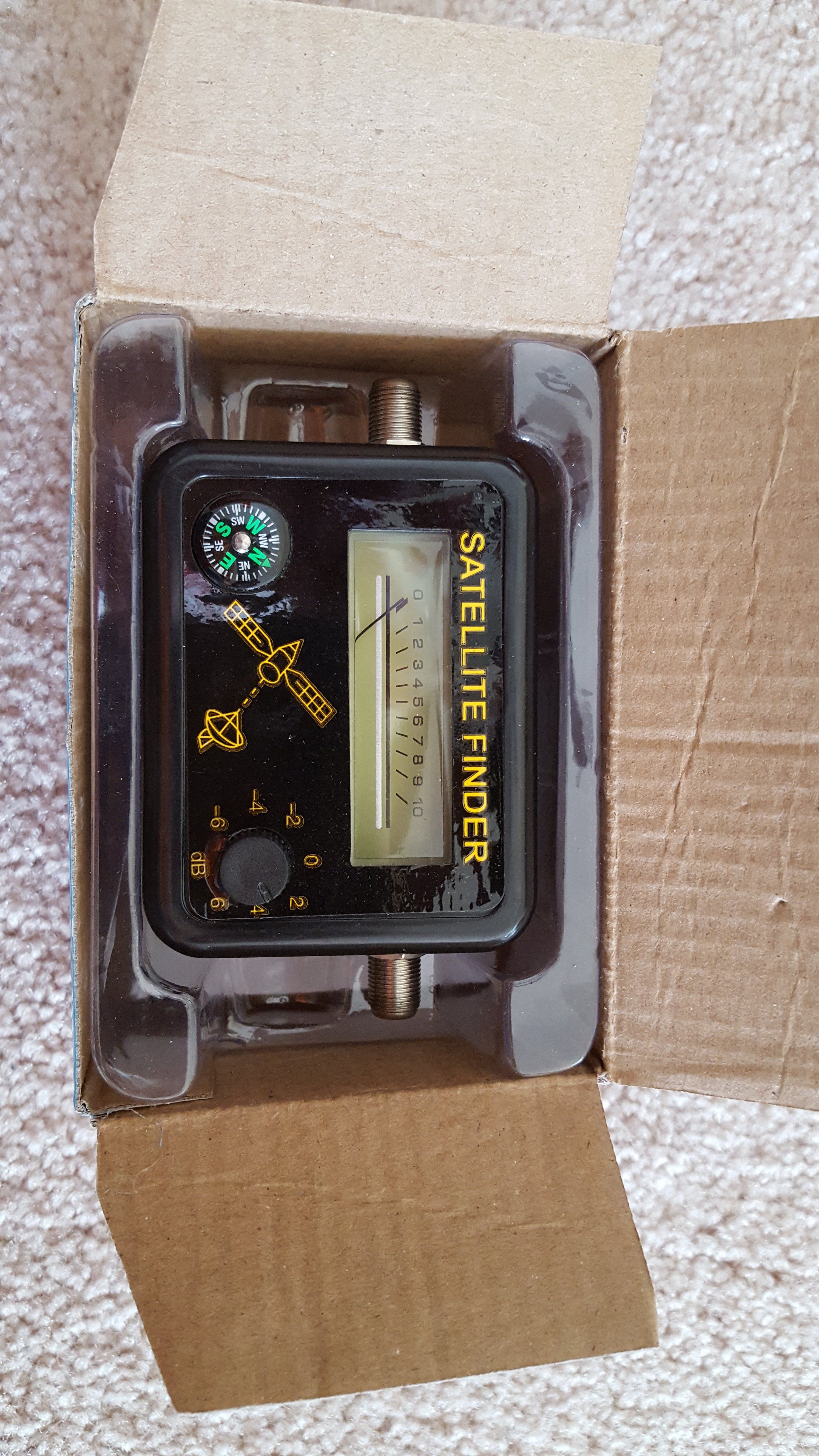

I ordered a meter off fleabay for $5
simple and no bells and whistles,I really only need it one time or so,I will post when I get it and try it out.

I got my satellite finder meter off fleabay a few days ago and just now tried it out,I was not out there 5 minutes and had galaxy 19 tuned in,this $5 meter worked like a charm!
I came in did a blind scan on my Geosat pro and WALLA..got lots of channels with 80% signal...I couldnt be more happy with the meter and reciever!
