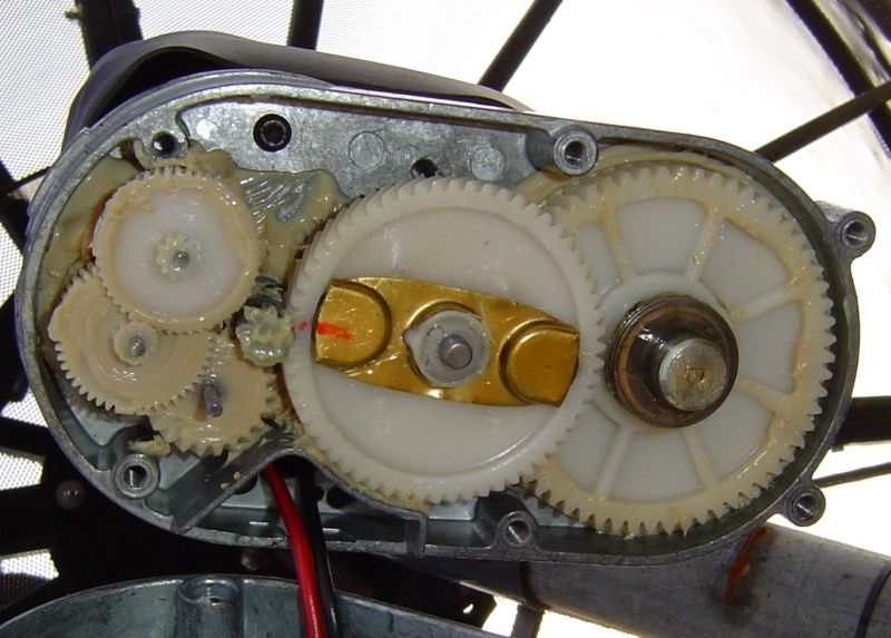

I went up on the roof today and pulled the cover off my 24" Von Weise actuator to just take a look.

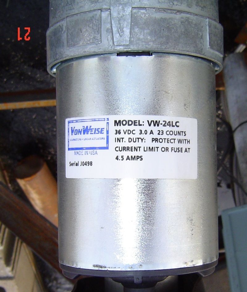

I got the model number which is a VW-24LC and called Von Weise in St. Clair, MO. I talked to a guy there who was very knowledgeable and told me how many counts per inch that my actuator was putting out. It turns out that it only puts out 24 counts per inch. That translates into a little over 400 counts in the entire travel of my actuator arm.
I never paid any attention to the total number of counts, and just assumed it was all up to par.
I asked about taking a magnet out of a junk actuator and putting them in, but they won't fit. He gave me the dimensions of the magnet I need, and said I should be able to find them in a craft or hobby store. He is sending me one, just in case.
The magnet holder on the 24LC holds two magnets, but they come from the factory with only one in place. I can double the counts by putting in the other magnet. That will make the positioning twice as accurate.

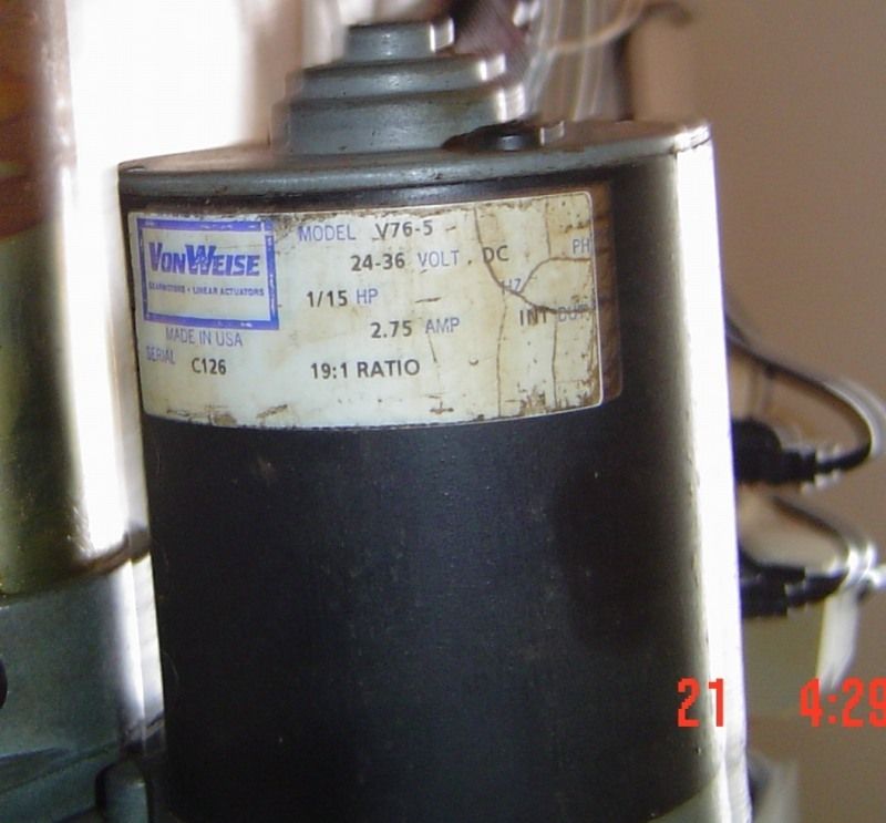

For what it's worth, I'm using a vbox II with a Von Weise 24" arm. I have the V76-5 model which is rated for 48 counts. I think I have something like 800 or 900 counts through the arc. I haven't had any accuracy issues and I've got pretty much everything from Intelsat 9 at 58 degrees to AMC7 at 137 degrees programmed into my VBox. I think you'll be very happy with your results once you upgrade your arm.
thanks Mike , i think thats the same model actuator i have on my 10 ft dish. your using a V-Box II with good results.

There is one magnet in there now. How does the switch get back after the magnet pulls it?
The answer is of course that it is spring loaded, and both magnets should pull as the single does now.
So I am waiting until the OEM magnet arrives (should be tomorrow) then I will install it with both magnets pulling on the switch.
One of the ones I bought would probably work fine, but is just installed backwards.

Basically, the reed switch will close when either a N or S end of a magnet is close to it (in a simple world)
If the mechanism has a magnetic pathway built into it (possible but not likely for a 70's design), that could complicate the discussion.
So, if a simple N--S magnet were to rotate slowly near a reed switch, the switch should close twice per revolution of the shaft.
Once when the N end passed the switch, and once when the S end passed it.
However, if the magnet were offset to the edge of a disc which rotated near a magnet, then only one pulse would be delivered per rotation of the disc/shaft.
There, putting two magnets on the disc... (or four, if you had small magnets and a large disc), would double (quadruple) the number of pulses.
Actually this actuator is probably a 90s design. It is one of their later models.

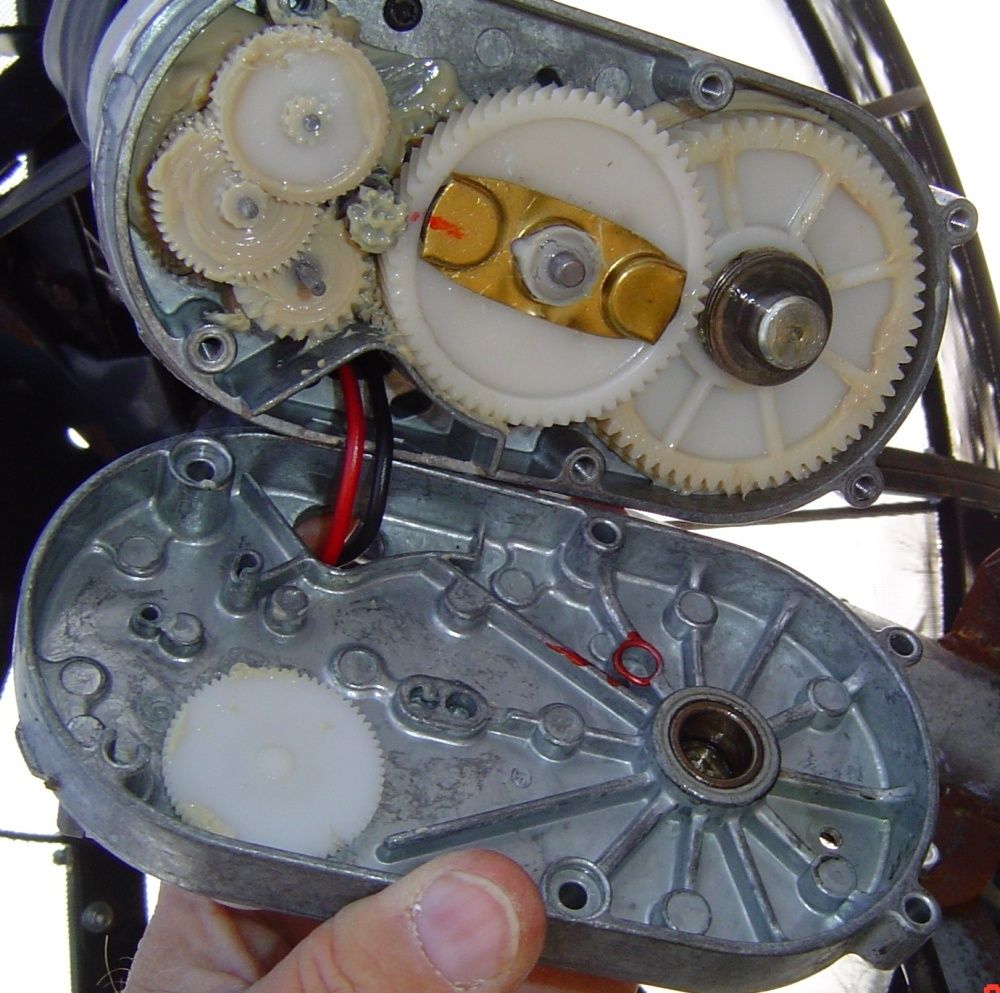

The magnet holder is made of brass and is slid onto a gear that sits between the motor gear and the shaft gear.
The brass holder is between the magnet and sensor which sits on the outside of the housing.
Somehow it works as is with one magnet. The single magnet is pulling from the direction of the sensor. There must be something that returns the switch to be pulled again the next time around.
I believe that putting the second magnet in place also pulling from the sensor will produce double the counts.
Right now it is 24 counts per inch of thread traveled.
That translates into 6 counts (pulses) between 91W and 93W. On all my other actuators it has always been 12 or 13 counts between those two satellites.

I got the magnet sent to me by Von Weise put in today, and it works as designed and effectively doubled the number of counts I was previously seeing.
It is now 13 counts between 91W and 93W. :)
I reset the VBox III and set the East and West limits and started programming the positions back in.
So far the accuracy problem seems to be solved. I will know more after I get all the positions programmed in and use it for a couple of days in the course of everyday viewing.
The Unimesh dish with the Co-Rotor (ADL designed probe) has turned the Unimesh into a signal sucking mamma for C and Ku. :D
I am able to get 43W to 148W with it, and the signal is fantastic all the way across the arc.

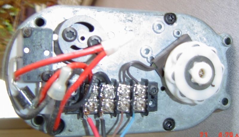

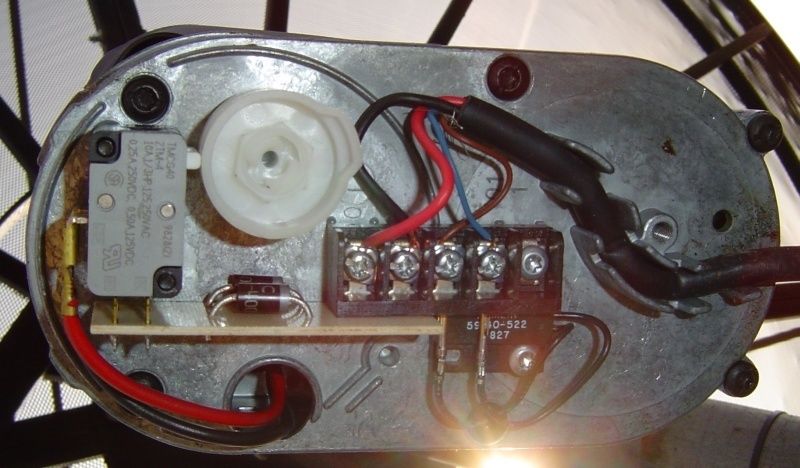

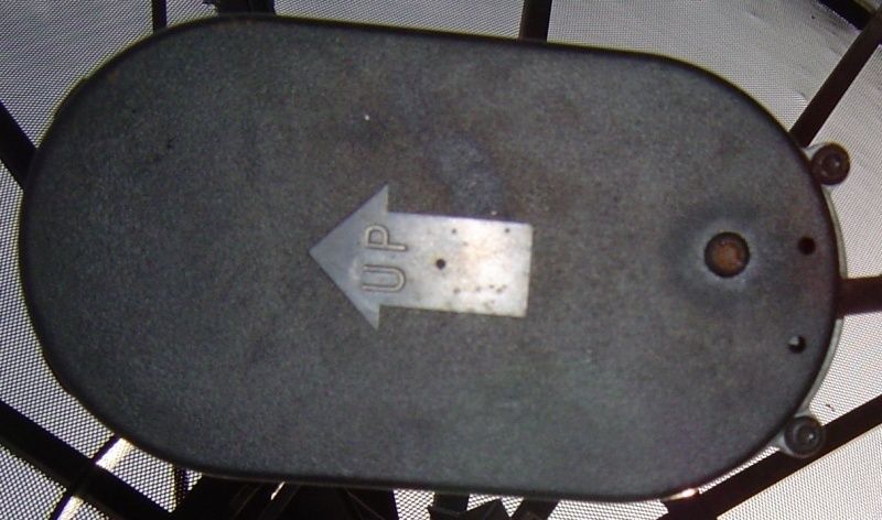

Here are the pics of the VW-24LC innards and the magnet holder. You will see a red circle where the sensor probe senses the magnets when you see the "open view". The last two pictures are of a V76-5 for those who have those actuators and want to experiment to add more counts.
