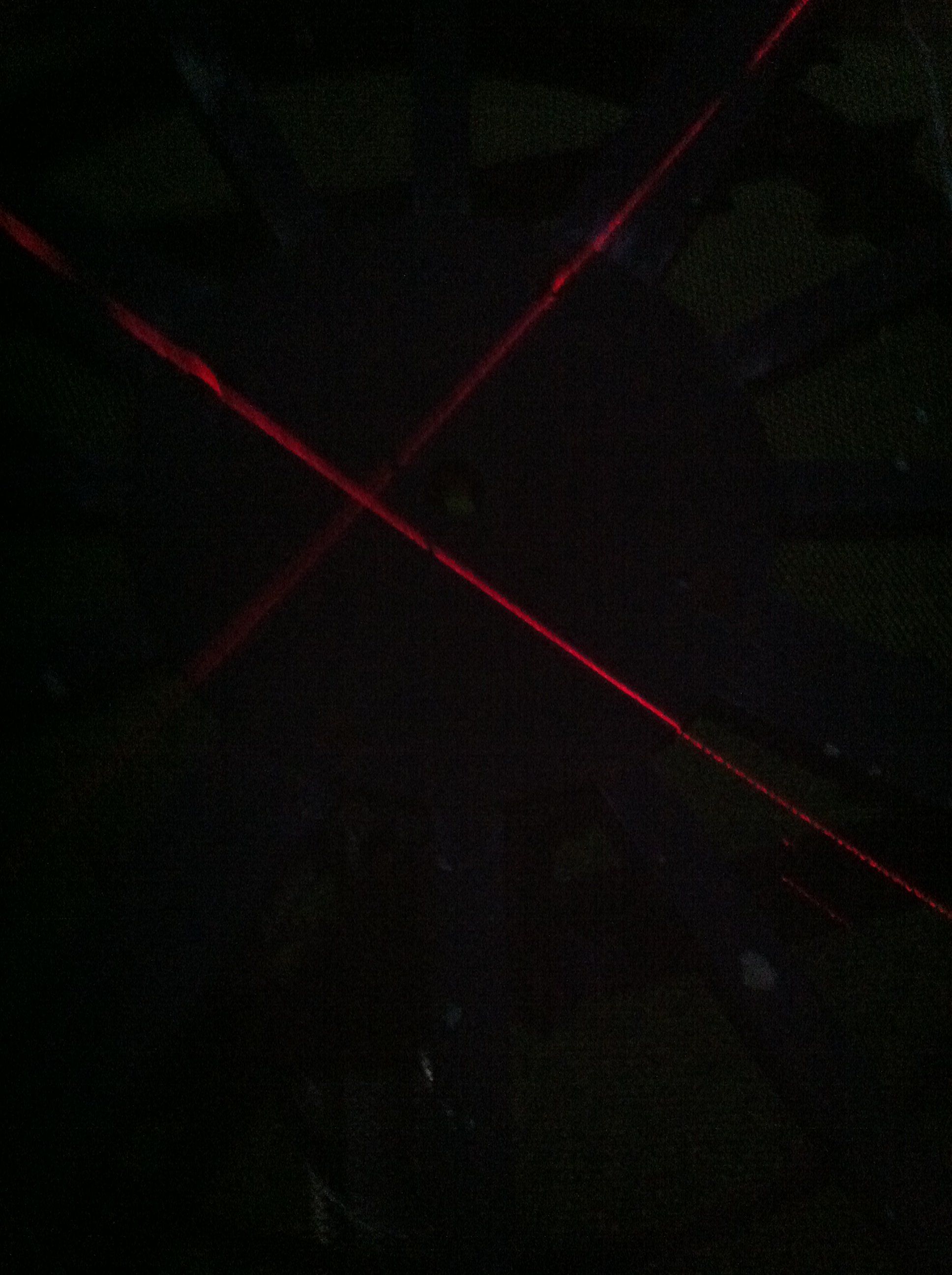

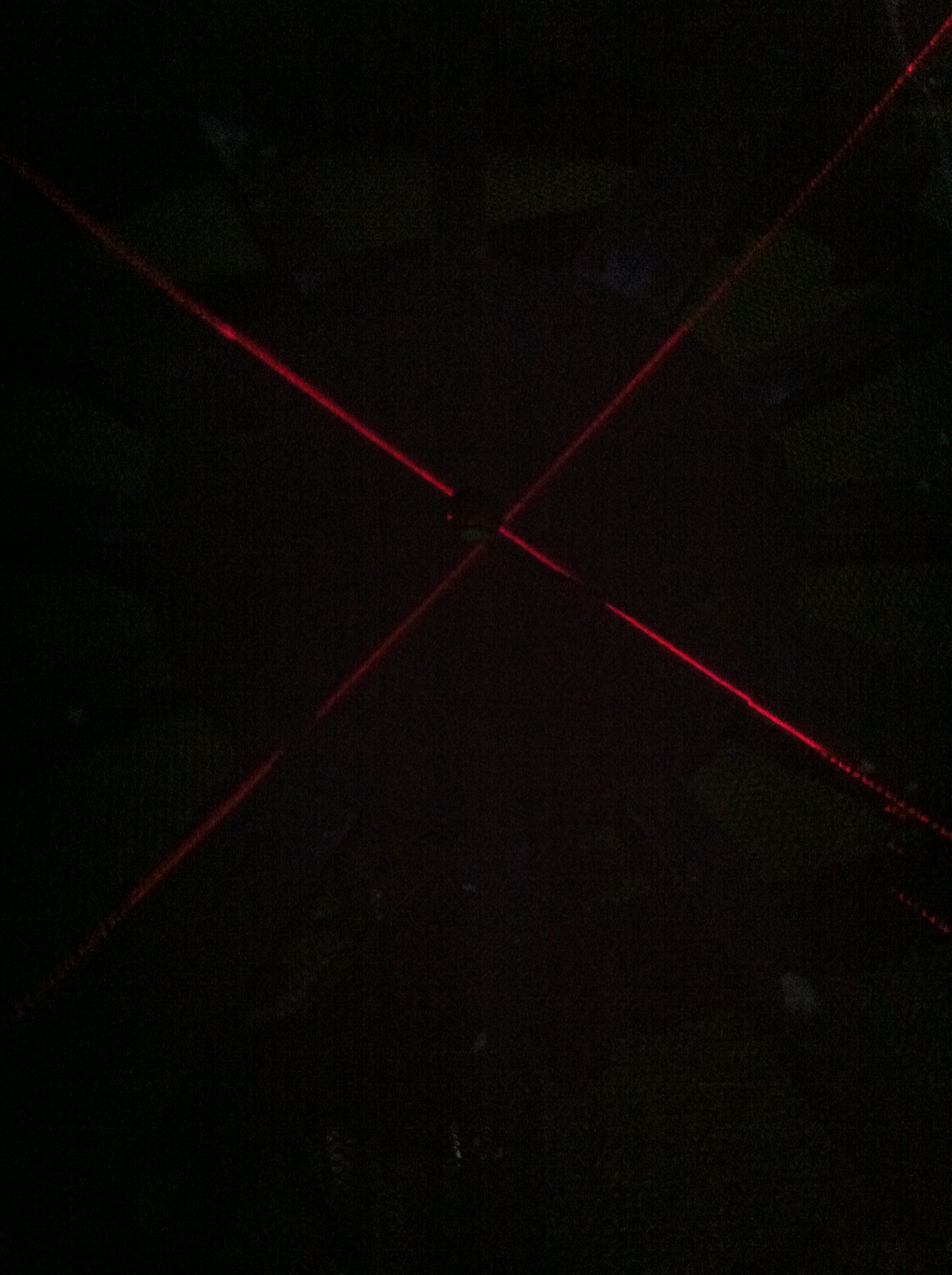

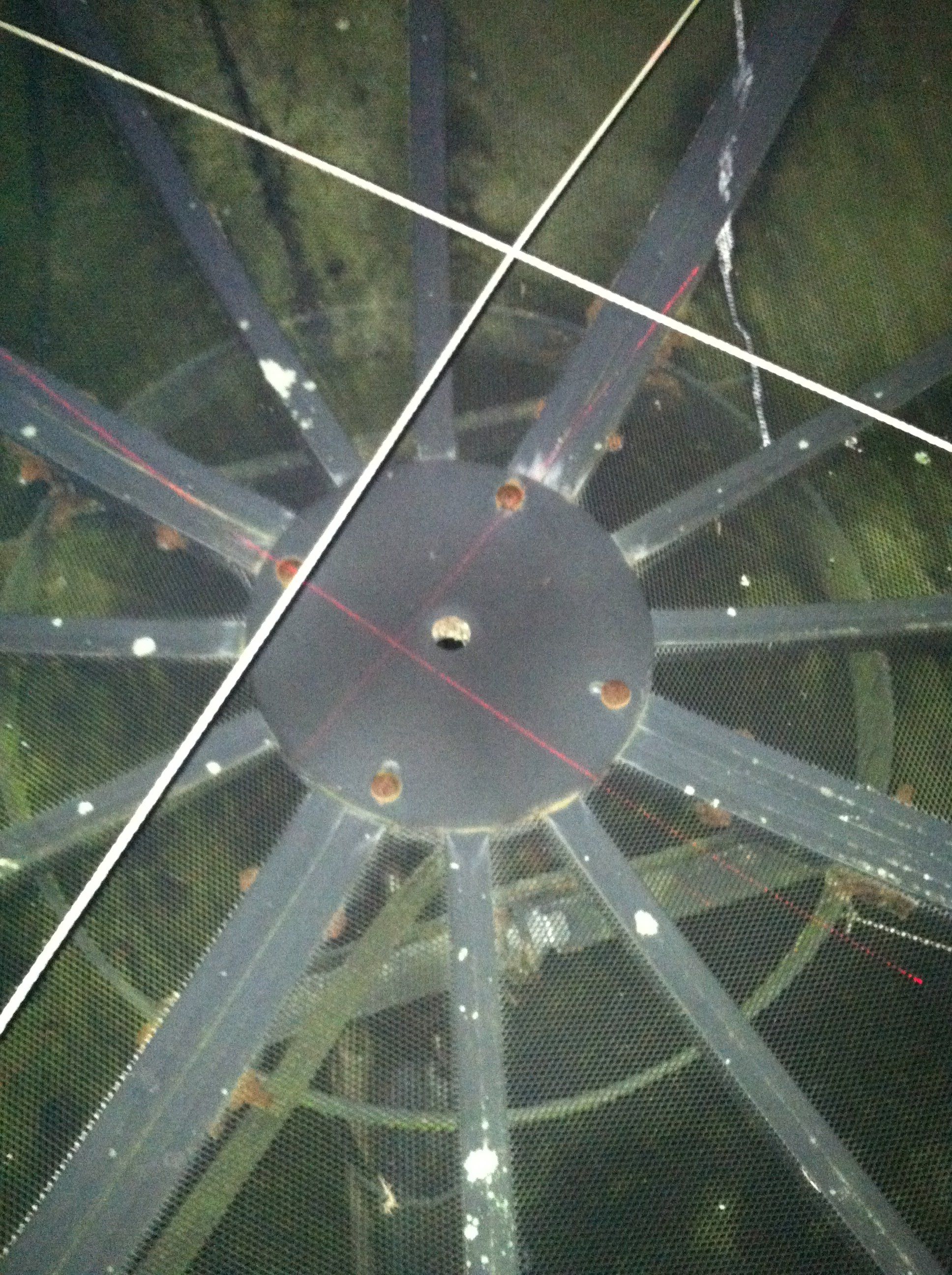

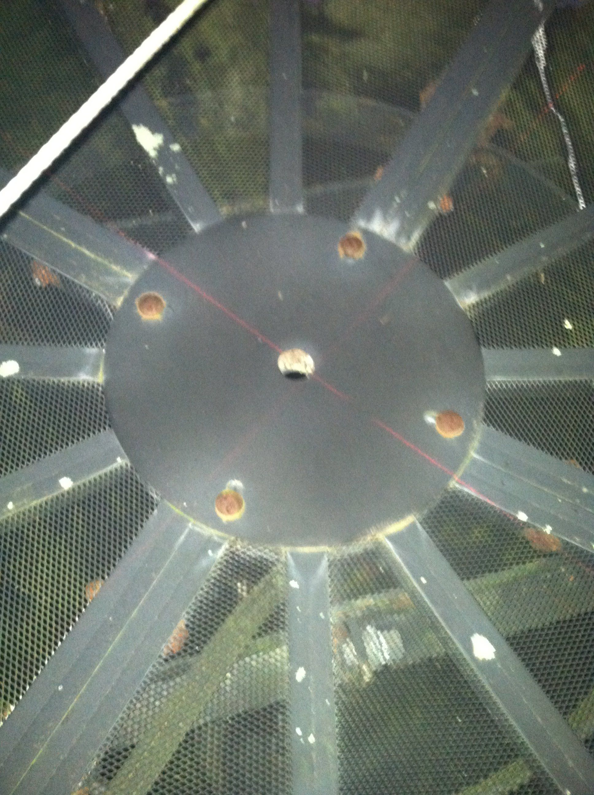

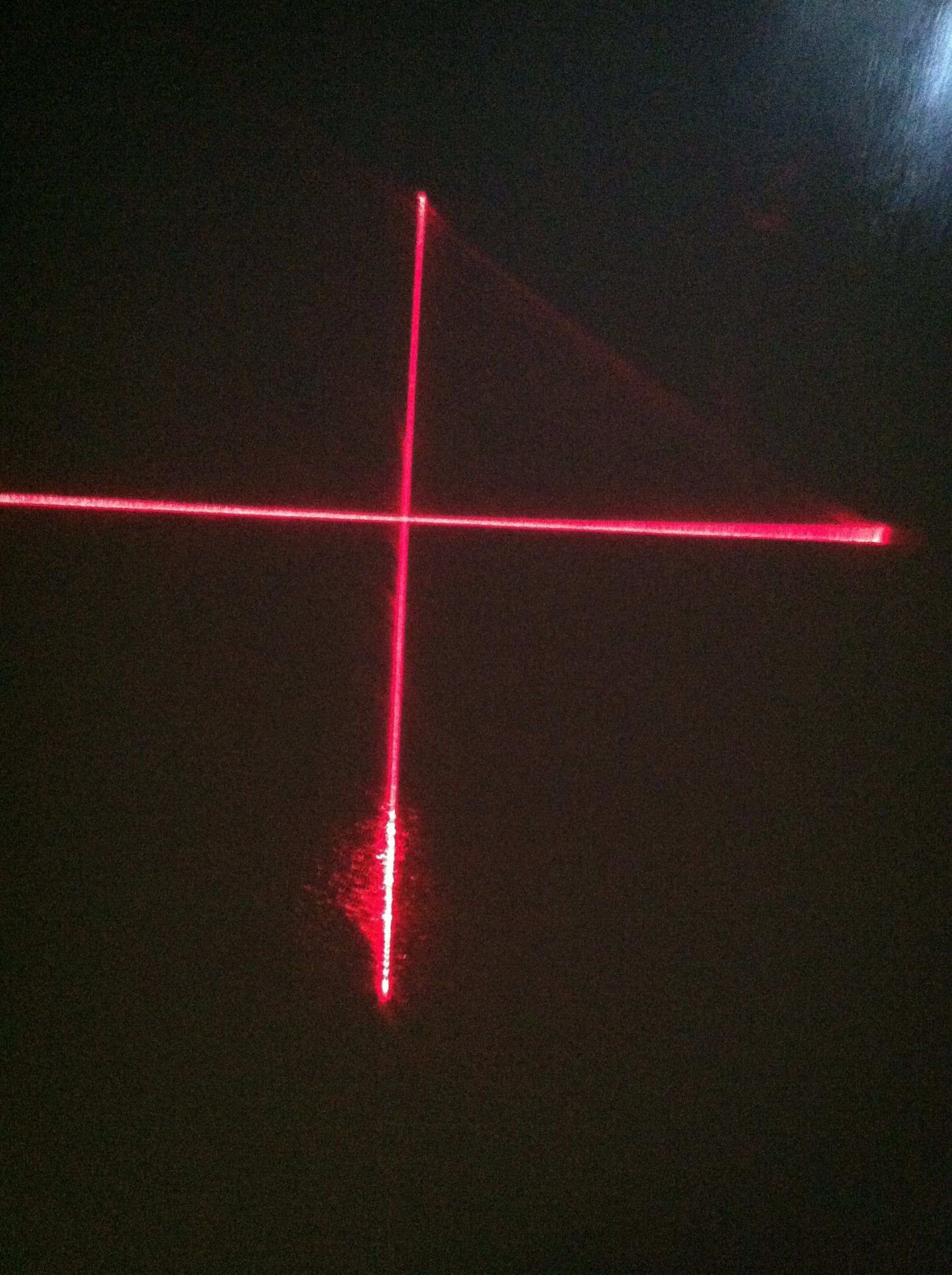

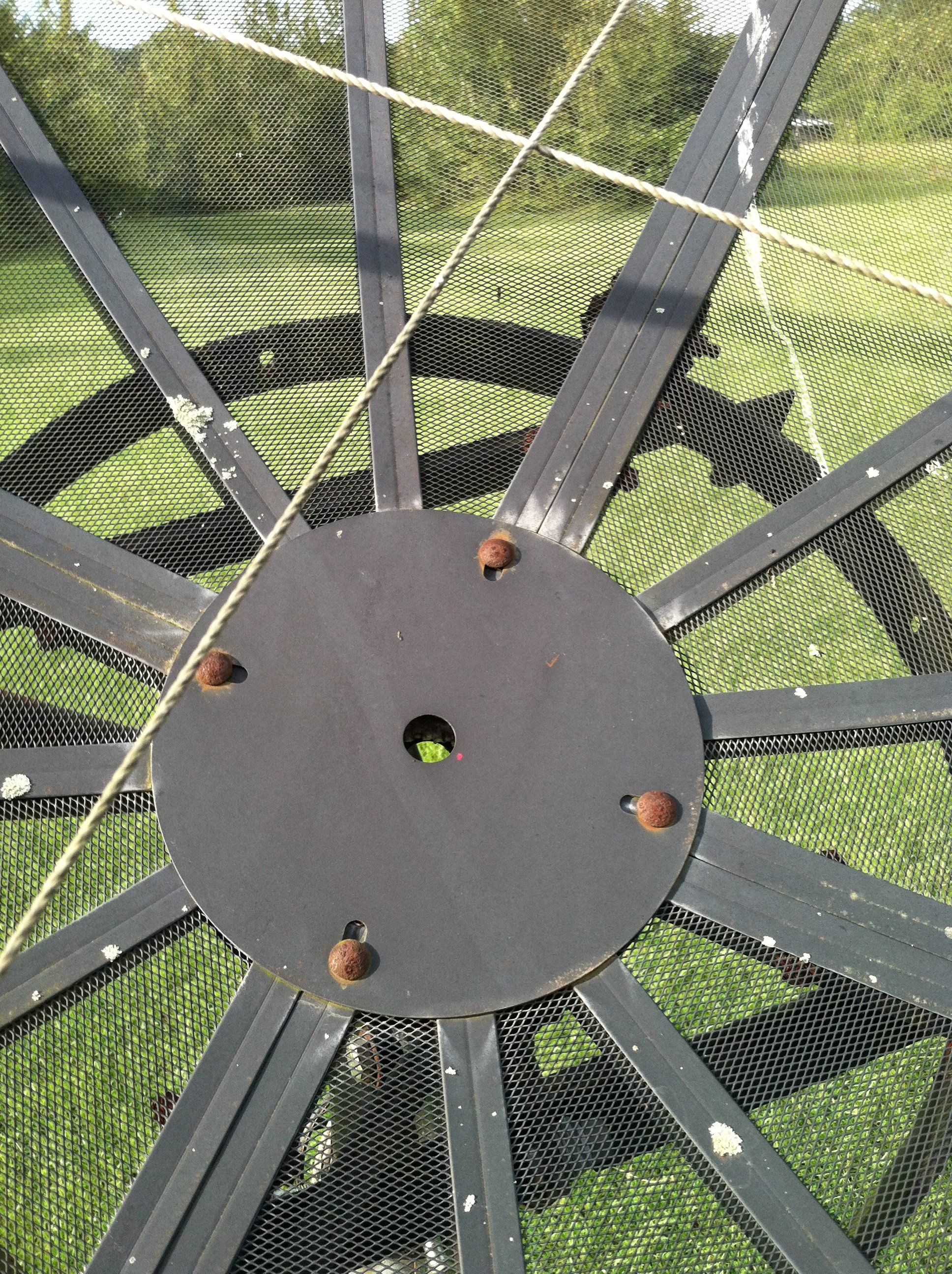

Well my first prototype is great ...... well there are some problems :) seems it can only be used in low light areas to traverse the distance from lnbf to dish
seems my laser light isn't powerful enough :( I bought a cheap crosshair type laser (650nm 5mW 3V Red Laser Cross Module Head)
so i will take pics of the basic build (i'll post those later this evening) and try to check alignment closer to dark

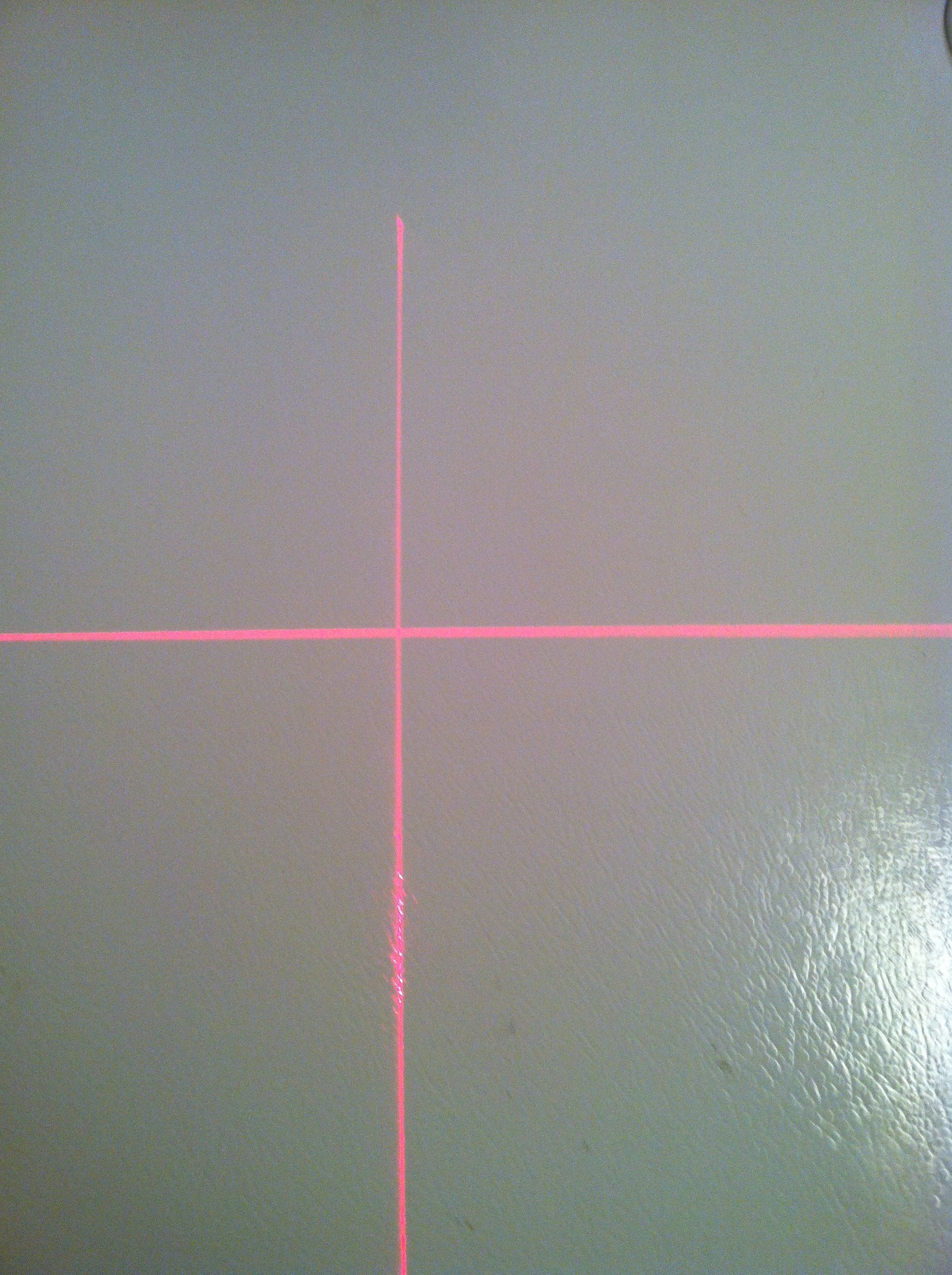

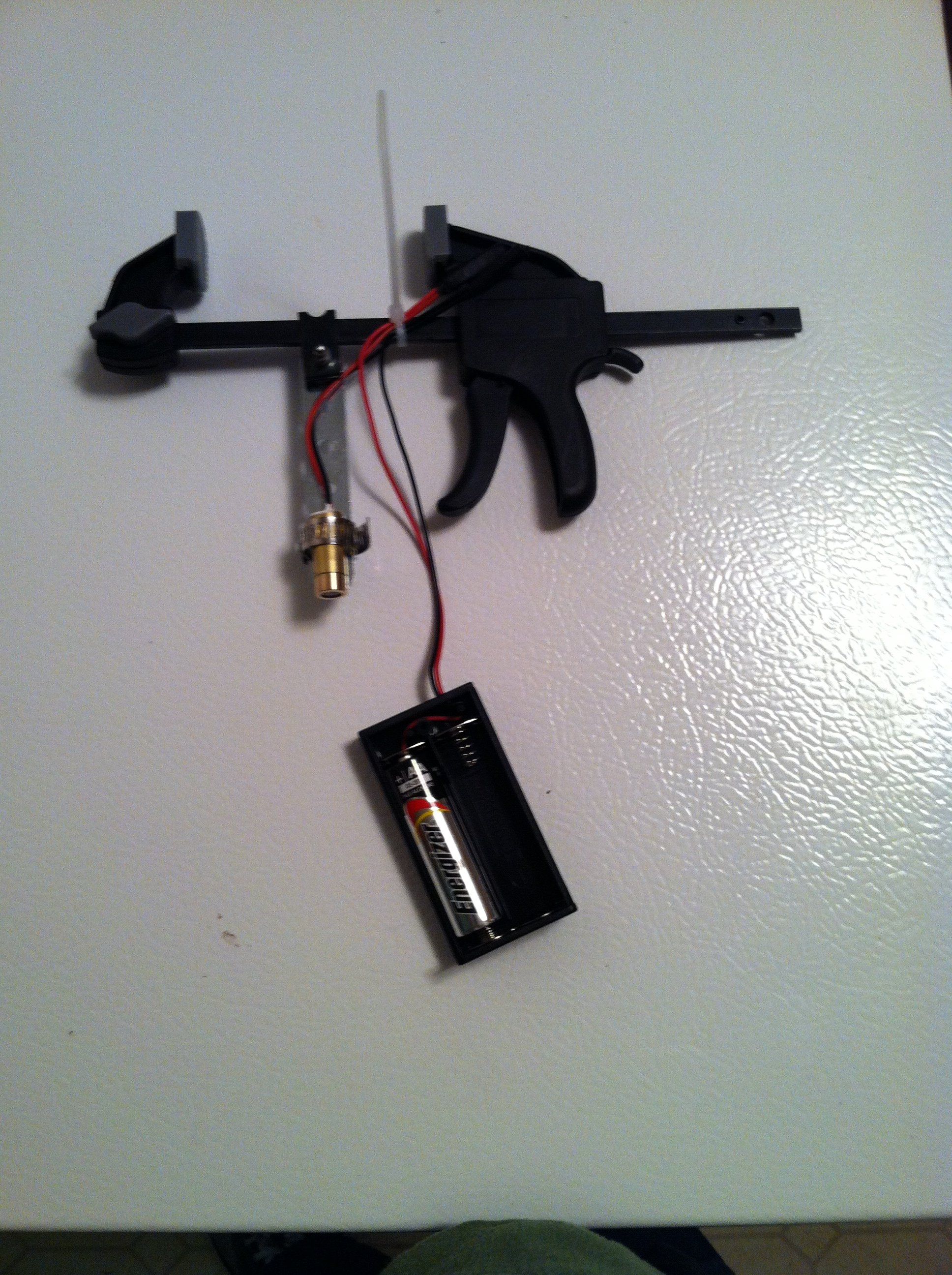

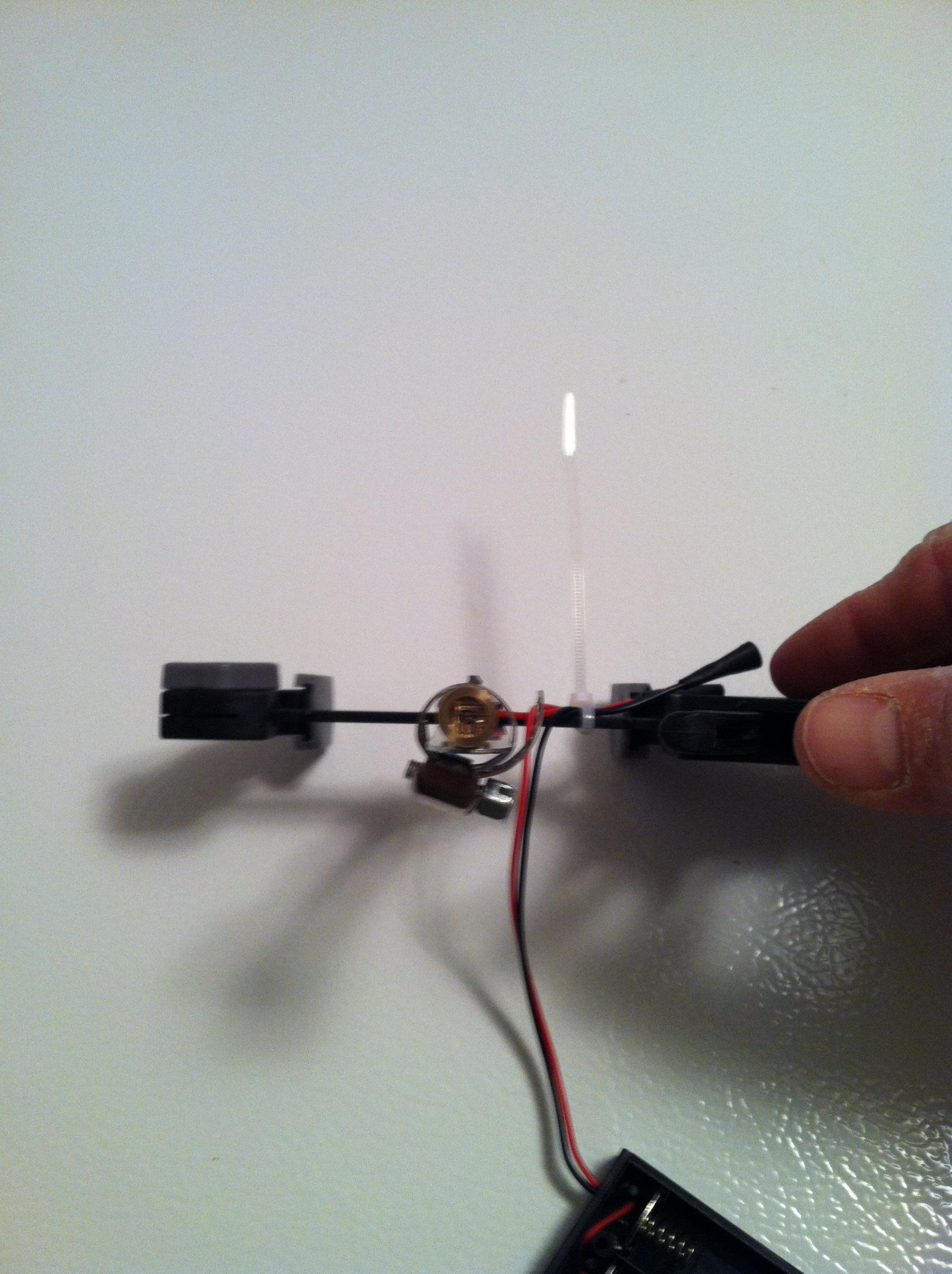

first two pics are of prototype
3rd pic is cross hairs on deep freezer at 2 ft lights on
4th pic is cross hairs on deep freezer at 2 ft lights off
5th pic is mounted to lnbf
6 pic is of laser pointer mounted to the side on same tool, its mounted about 3/8 inch toward right and this is where dot shows on dish

ok i meant to try it about 1 hour before it got dark but i missed that cause i was working on another project.
1st is lnbf with flash on second is lnbf with no flash
3rd is scaler with flash and 4th is without flash also note i didn't adjust laser for scaler so its pointing about 1/2 inch right

ok parts used for this prototype
1 clamp 4" harbor freight on sale this week $1.99
1 laser cross beam $1.10
1 AA battery holder $0.72
1 automotive clip $0.59
1 mending plate 1/2" X 3" $0.24
1 zip tie $0.03
1 screw (i had) $0.05
electrical tape and soilder ( i had) no cost
build cost about $4.72
the laser i used was a 5 mW it wasn't bright enough to see during the daylight, anyone got suggestions on the the power laser to use
