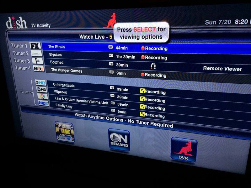

So I had something interesting happen tonight and I'm trying to get some info on it. I have a Hopper, Super Joey and a wireless Joey. So I have 5 tuners(or 4 during PTAT). So tonight during PTAT I had 3 recordings going on as well a PC taking up a tuner. As you can see in the picture all tuners were being used. Now the funny thing is I turned on my wireless Joey and I was able to watch live tv flipping through channels? How was I able to watch live tv if all the tuners we're be used? I'm a bit stumped?
You would be able to flip through the PTAT channels on the wireless Joey without interrupting anything, but you would not be able to get to satellite channel. If you were able to go through the satellite channels, I would think that you might have kicked the remote user off, but someone would have said something if that happened.
Because you were only using 4 tuners for your recordings and ptat, with the super joey system you gave total of five tuners. Not sure how the wireless joey works never installed one. Good question
Hopper with Super Joey - PTAT off - 5 simultaneous recordings possible (5 tuners).
Hopper with Super Joey - PTAT on - 8 simultaneous recordings possible (4 standard satellite tuners plus one tuner recording the PTAT stream of 4 network channels).
Add an OTA tuner and each count goes up by 1.

With PTAT turned off you can still record the big four networks simultaneous anytime if you wish on one tuner.
I had something odd regarding this also. I have PTAT turned off. I was recording three prime time shows however it showed as taking two tuners. All shows were within prime time time frame.
Were all 3 primetime shows on the big 4 networks? If one of them was on the CW or a subchannel station, then that would take a different tuner.
As earlier post: did the OP take over the Slinged tuner? Maybe nobody noticed. Also, we presume he was flipping through channels OTHER than those recording or being Slinged, right? Because, yes, the OP might have been flipping through the channels the Hopper system was already tuned to. Sometimes that happens to me. I mean I am usually sent to the TV Activity screen and forced to choose, but a few times it took me right to one of the channels I was recording and when I pressed channel up or down, it took me to the other channels I was recording. That seemed unusual to me.
