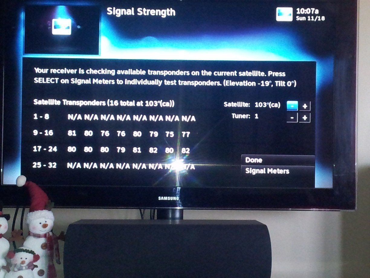

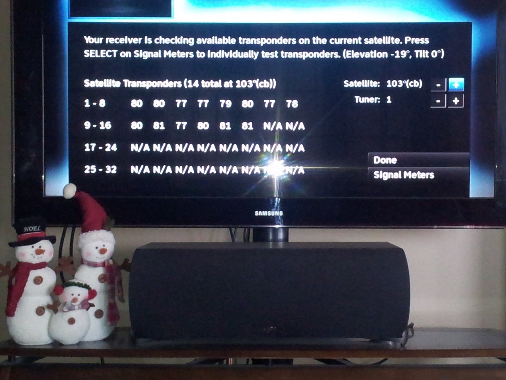

sms=100
Upon activation, it appeared everything went smoothly. He is subscribed to Premier, and I'd say 95% of the channels are getting 721 error not subscribed. There is a grouping of about 50 channels between channel 2 and channel 108 that are working, but nothing else. I've called customer service 3 times for re-hits. Unplugged the receivers, re-authorized online...Finally I got fed up and had to go to bed. Looking to work it out today before Football starts. Any ideas on what could be causing this error?
Your numbers on 103 are too low. You need to repeak the dish. Can you post all of the signal strength numbers?
All transponders are 75 and above, phone agent said that should be good enough to view all programming but rain fade would be a problem.
Using Lyngsat, going to try and see if it's only 103 SAT channels not coming in.. I doubt it though as he only is getting like 50 so I am guessing a lot of 101 and 99 aren't coming in as well and those signals are all over 90

raoul5788 said:
Perhaps, but the dish still needs to be repeaked. Please post all of the signal strength numbers.
