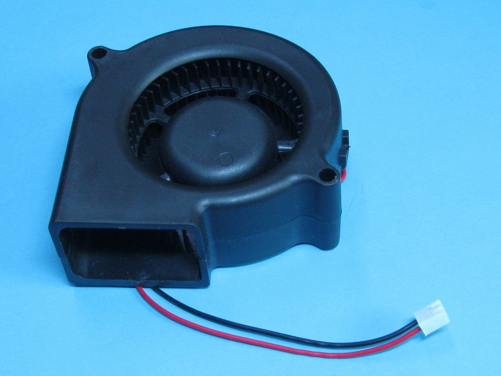

Nothing comes even close to this fan blower fan.JPG when taped to the rear left corner slots of the receiver sucking the hot air and blowing it out the back. You can buy it on Ebay for about $7 and the only problem is that you will have to solder a standard USB connect to it (make sure you select the 5V fan). If you use any USB fan, make sure it draws less than 1A (<5W).
