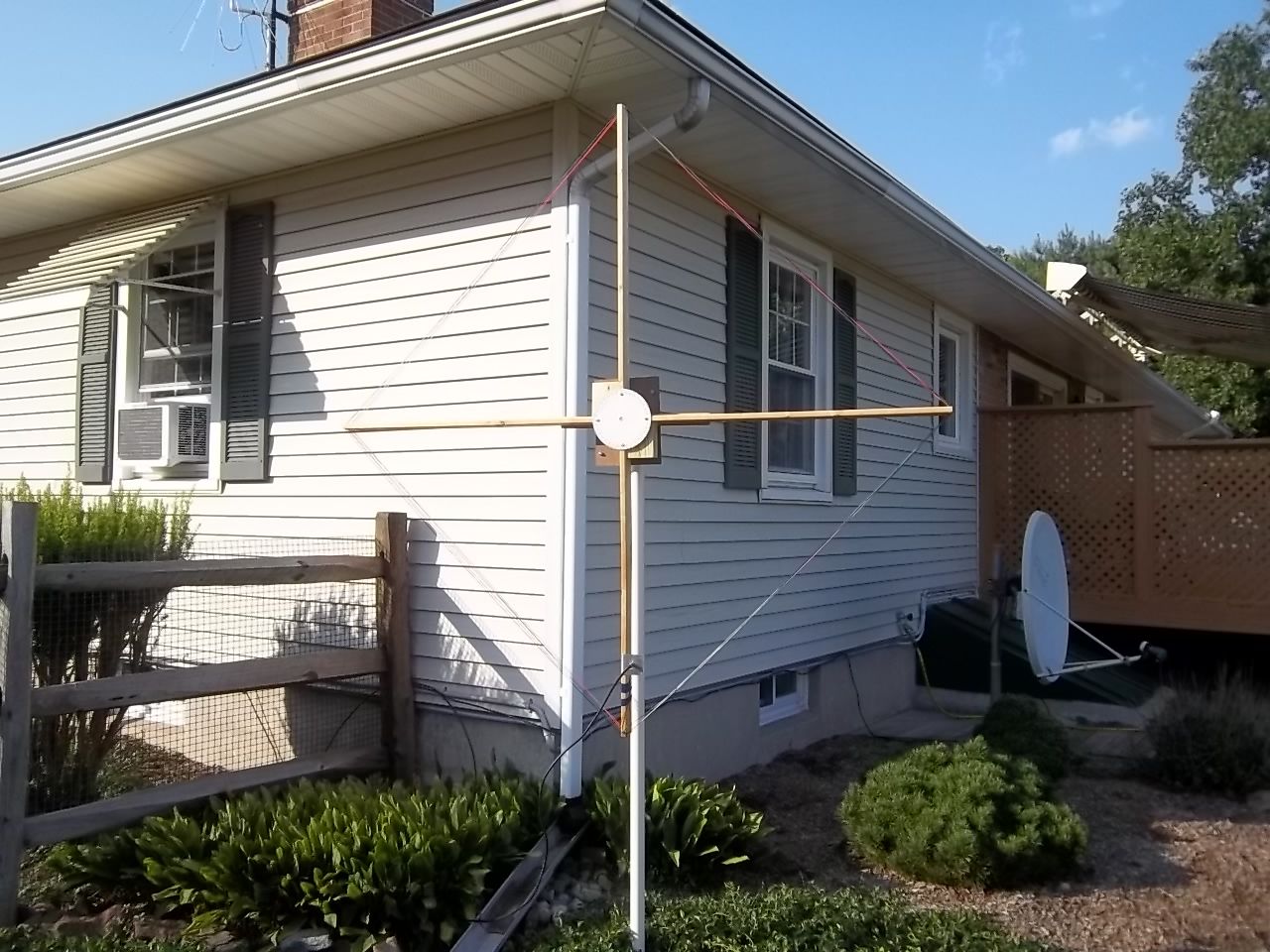

When you get tired of listening to man-made RF, build yourself a special VLF antenna (see pic) and attach an audio amplifier to it. If you are far enough away from power lines to minimize AC hum, you might hear sounds coming from nature such as spherics, dawn chorus, whistlers etc. Spherics sound like frying bacon (or like Rice Crispies when you pour in the milk) and are the most common sounds from nature to be heard; these are generated from thunderstorms at least 600 miles away.
The antenna is just 1 x 3's with hook up wire strung around it and held taught. Mine has 5 turns of wire, with over a hundred feet of wire all in all.

With the antenna built below, which is a little over 4 foot square, and an audio amplifier (Radio Shack still sells them, get 'em while they are still around) you can have lots of fun checking into what nature is "transmitting" when the other HF bands are not so entertaining.
