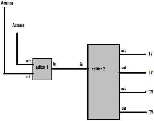

I just have a question regarding running the regular antenna into the TV 2. I
wanted to run the dish 622 TV 2 too two TVs and I wanted to run the regular
antenna line to those TVs also. Is there a splitter that can run two IN instead of
just one IN. The normal ones only have one IN and the rest are out.
I hope you can understand my question.
You can combine splitters, and if you use a splitter in reverse it is then called a "combiner." Example, a 2x1 connected to a 1x4 to feed four tvs from two inputs.
