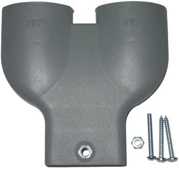

Sorry, but that is backwards, if you are looking at the lnb from behind the dish, the lnb on the left is for 119, they are backwards to their position in the sky because they reflect off the dish. Also a D500 Y bracket has labels for 110&119 right by the lnb.
Your original problem was simple, you were just off by ~10 degrees to the west. point about 10 degrees east and search for a signal in that area. Covering the 110 lnb isn't a bad idea, if you make sure you cover the 110 lnb and get verified 119 signal inside, you should be good to go once you uncover 110 and run a checkswitch test.
