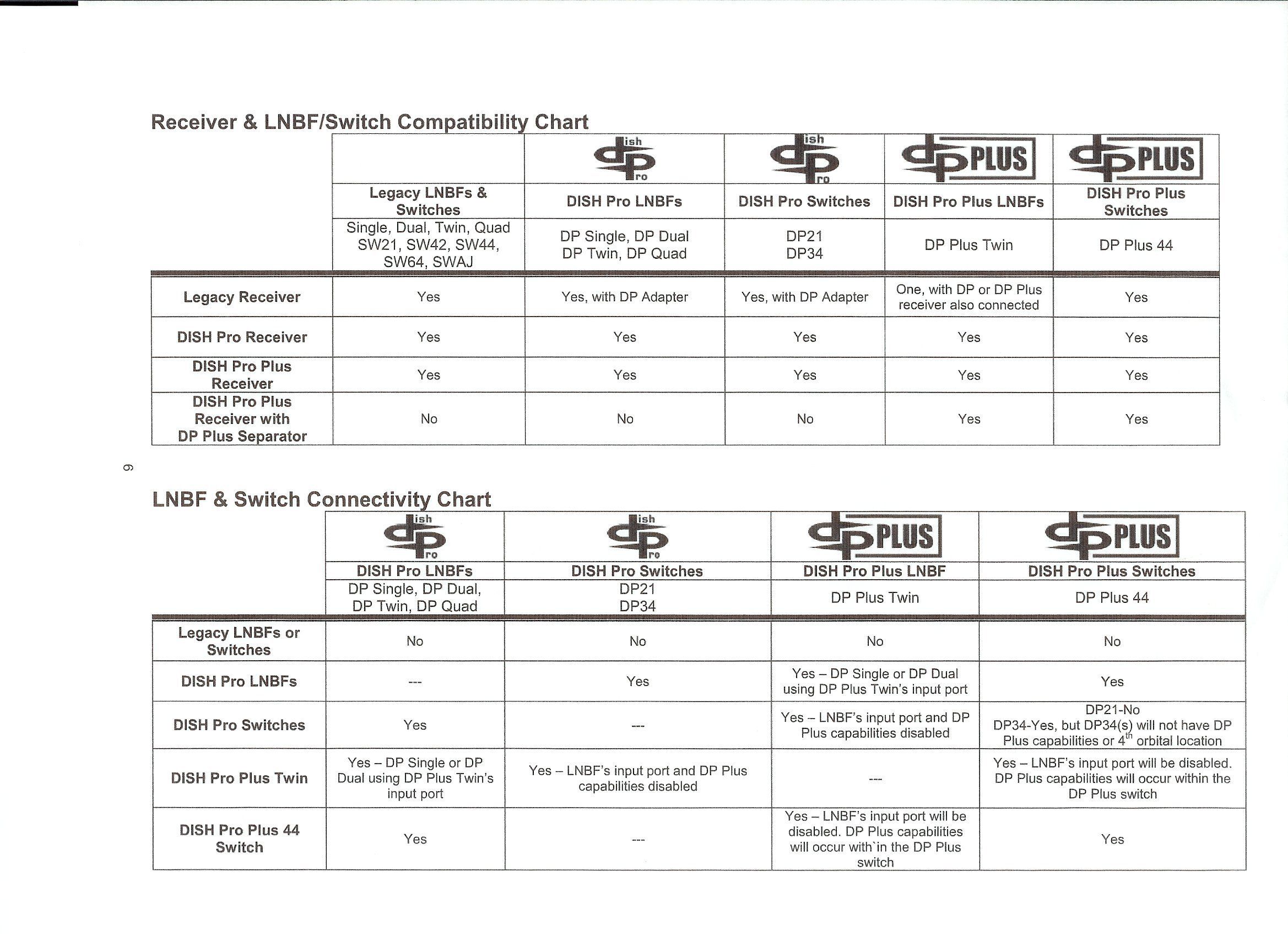

Mike, If I read the above correctly, you plan on having a total of four receivers in your home--two of which will have dual-tuners. The DPP44 will support this nicely and only require one run of RG6 coax from the DPP44 to each receiver location. It does not matter if SD or HD (including MPEG4), the separators will work just fine for both dual-tuner receivers. The only requirement is to have compatible LNBFs. I have attached a scan of the compatibility chart. Hope this helps.
My head hurts when I try to figure out the new pricing. I will let someone else answer that part for you. Bob
Yes, you understand it correctly but only 3 rcvrs. You answered one of my main question's. I'm with you on the pricing headache. I feel like I've been cramming for an EXAM for the past 3 days, just to get up to speed on the HD/MPEG4/DP1000, or anything else that I've forgot about.
