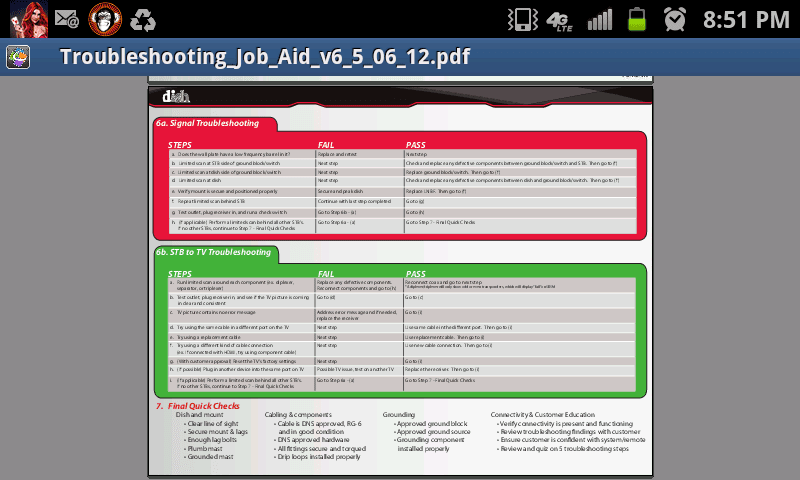

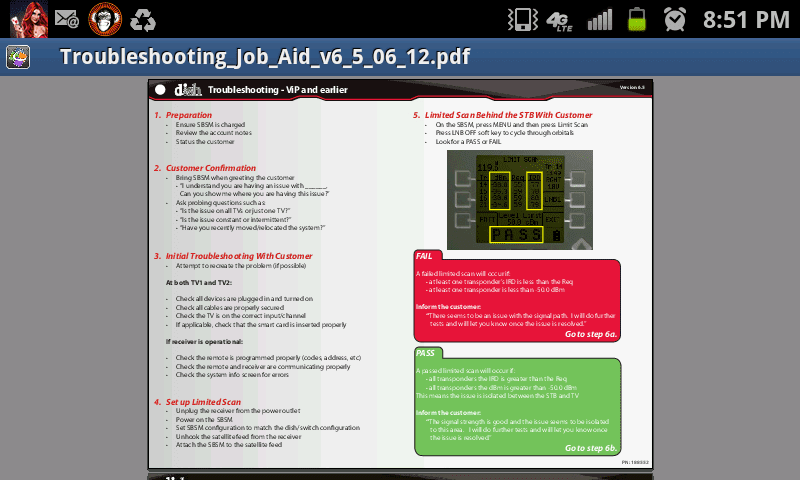

Next time your Tech comes to diagnose your issue you now are armed with the trouble shooting guide that all DNS (in-house) techs are required to follow.
I don't think either tech did that great of a job. The first Guy didn't even go inside to verify your problem before starting working on your system. He should have started from the inside at your reciever checking for errors on the system info screen. Then unhooking the sat cable and placed his meter on to see what the meter says about signal and dbm level. If the dbm is less that -50 or signal isn't up to minimum he should have worked his way back at each component in the system till he finds where the signal or dbm level reaches acceptable levels. And replaced parts as needed.
While it is preferable not to access a roof to mount or even service a Dish. We are provided fall protection which must be used (as per OSHA) to do so if necessary and as a last resort (for mounting not servicing).
Second tech should not have just swapped out your reciever till all the steps in the troubleshooting guide were covered.
