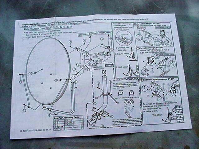

The instructions are detailed and complete, taking up both sides of a standard sheet of paper. They were written by someone fluent in the English language, and knowledgable about the product and FTA satellite TV reception.

dishfront.jpgdishback.jpgbracket.jpglevel.jpginst1.jpginst2.jpglnbfcompare.jpgscalarcompare.jpg
