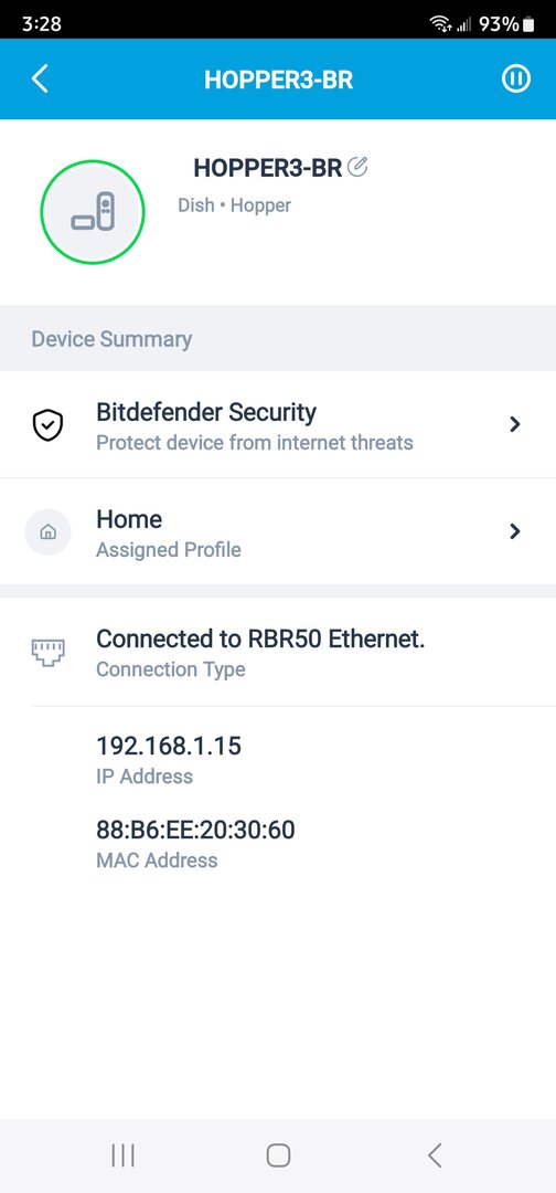

WOW, I thought it was just me. I am seeing strange things too in my Orbi mesh router. I use the reserve IP method in my router. Recently started seeing a strange Mac ID that says it's a Hopper. (see attached pic) Tried everything to figure out what's going on. It's either something strange from the Hopper or my Orbi router. I checked in the Orbi forum and found there are Mac ID issues happening so I am leaning towards my router is the culprit.
Reactions: HipKat
