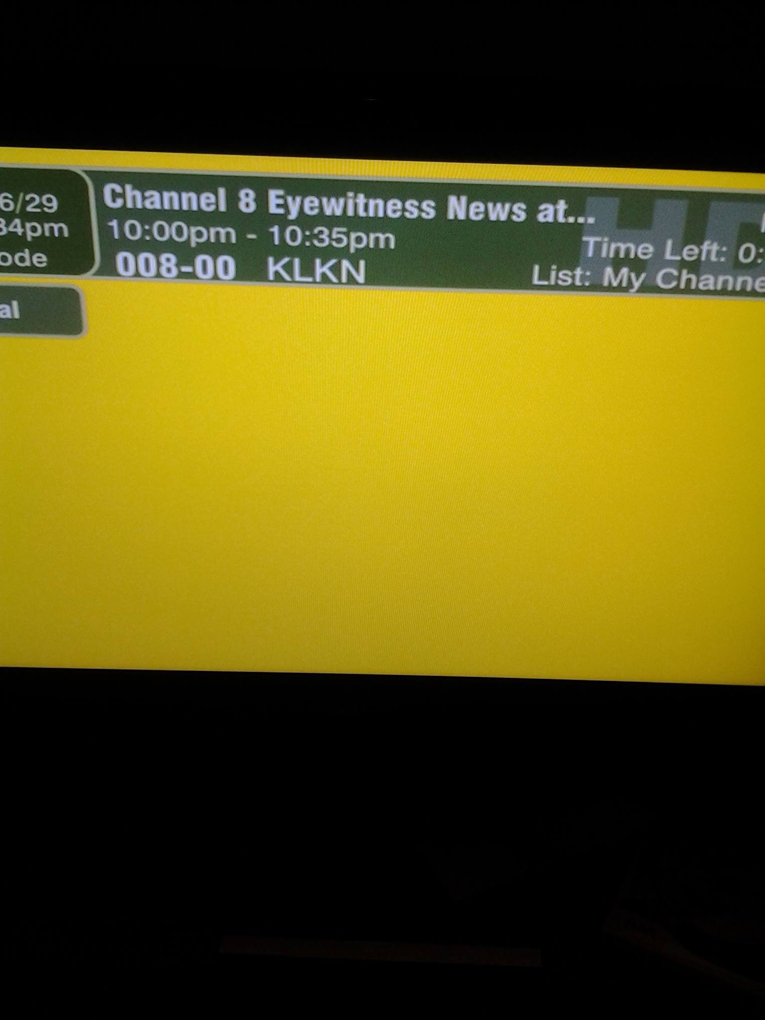

Two local channels in the Lincoln NE market, 10 KOLN/KGIN and 8 KLKN are all yellow. No Audio, No video. Both on SD and HD. Both are off of the 110° West satellite, spotbeam 27.
Only these two channels, other channels work fine.
Channels 10 KOLN/KGIN and 8 KLKN are still yellow with no sound or picture as of the time I posted this on Saturday morning, 6/30/2012.
