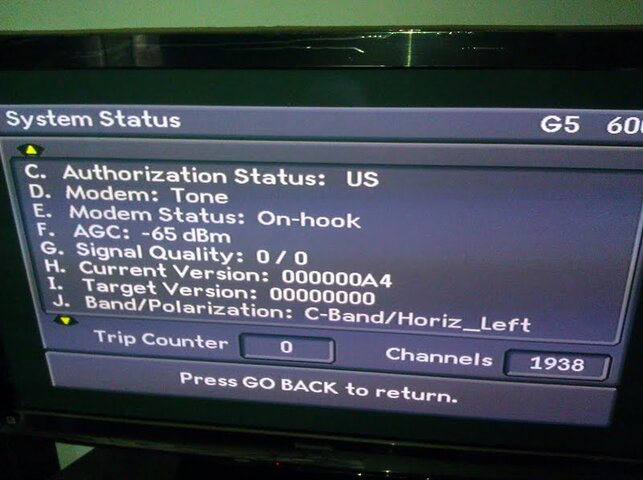

Congrats! RRob!!!!
no more ratings ceiling bug for your 922!!!!
Now make sure you post it everywhere you go that you changed out your 922 firmware back to A4 by yourself!

Once this is done this is what you will notice....
nothing different except that whenever a picture is FTA it will actually show up on you TV and not some gray screen saying...
"MISSING RATINGS CEILING INFO"
I bet it took you all of like 10 minutes or less to do this too!
