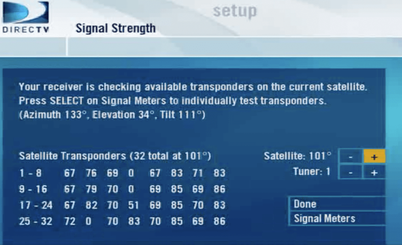

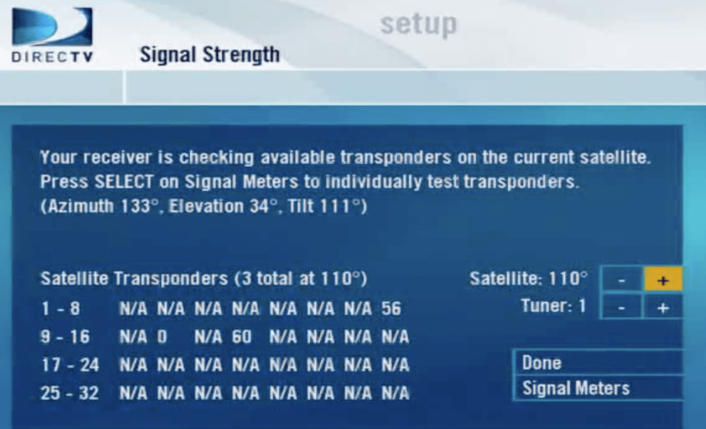

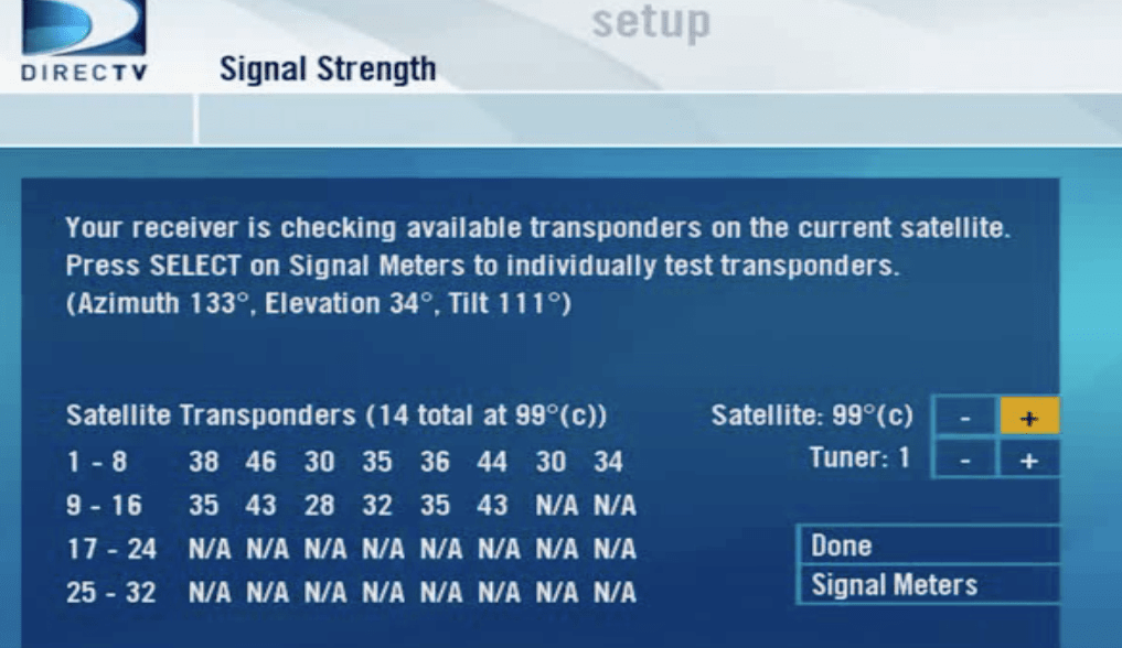

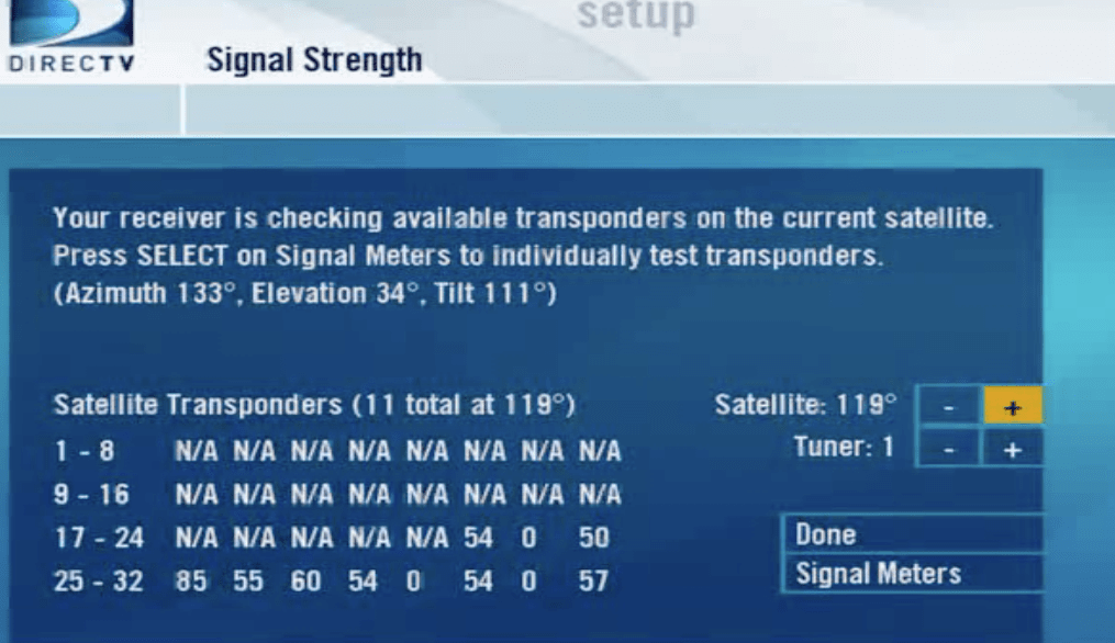

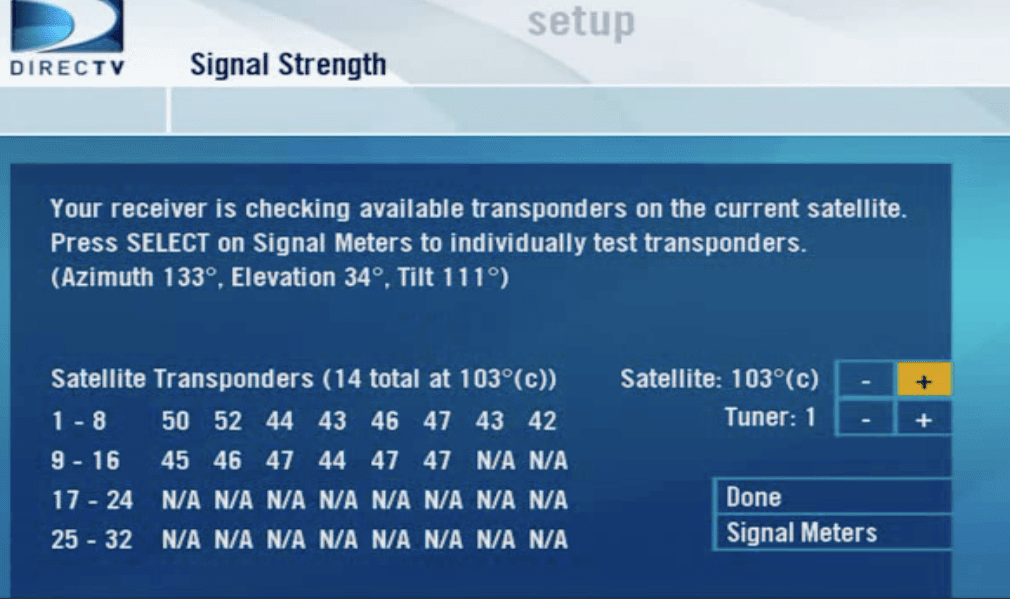

hi am in oregon and it snowed here today about two inches started when it got dark and
i am having problems with the 101-110-119 satellite but not 99-103 no pixilation at all look at these signals i will be trying to clean the dish of tomorrow but i might have a hard time as it will only be around 25 for a high and 17 for a low
any ideas would help

Cover the dish with an approved cover or use a heating device. Some have even said non-stick spray may work but I have never used it.
Wouldn't the "Non Stick Spray " Not Stick to the surface and run off the reflector ?
This is the experience I have had with these items.
I have had no luck with the Pam type stuff and the Rain Fade stuff as well.
skihoodoo,
My suggestion, try the heating devices.
Not a gutter heater, they are too long and a mess to deal with.
If your in an area that get snow regularly, I would definatly look into the Ice Zapper type of thing.
