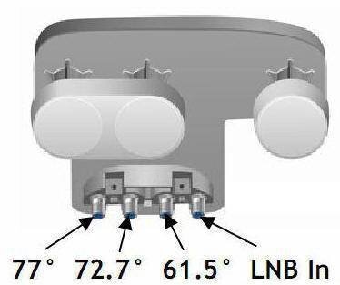

Sounds loike a DPP1000 with the dual LNBF for 119/110 and a single LNBF for 129. Works fine with a Hopper and that is what I have for a ground dish.
The switch in the dual takes the single from the single and combines it.

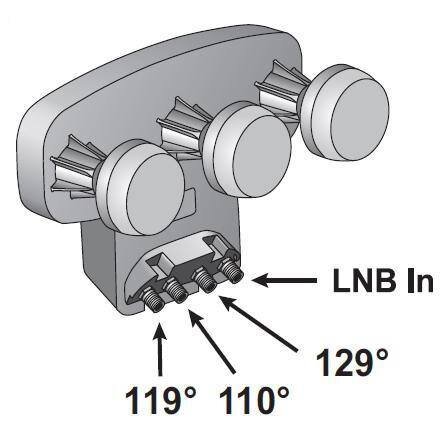

Here are four examples of Dish 1000
All but the first will work fine connected directly to the node. The first one would have to have DishPro LNBs (not legacy), and would need a switch, either a DPP33 or a DPP44 between the LNBs and the node.
34 is a DP technology and will not work with hopper. You need DPP 33 or DPP 44 as mentioned earlier, if you need a switch at all.
If the lnb's are DP, change the DP34 switch for a DPP33 or DPP44 and then run two lines to the single node. The line for the Hopper gets connected to the host out on the node and any Joeys to the client. If the lnb's are DPP (which I doubt you have), remove the DP34 switch and run two lines from the dish to the node. Outputs from node to receivers would be the same.
It sounds like you have the 1 with the 3 seperate lnbs at the end right? Each lnb is only picking up 1 orbital so you will need a dpp switch (33 or 44) then connect that to the node. But honestly i try to keep the system as simple as possible. If you can get your hands on a 1000.2 that will makes things work much better
