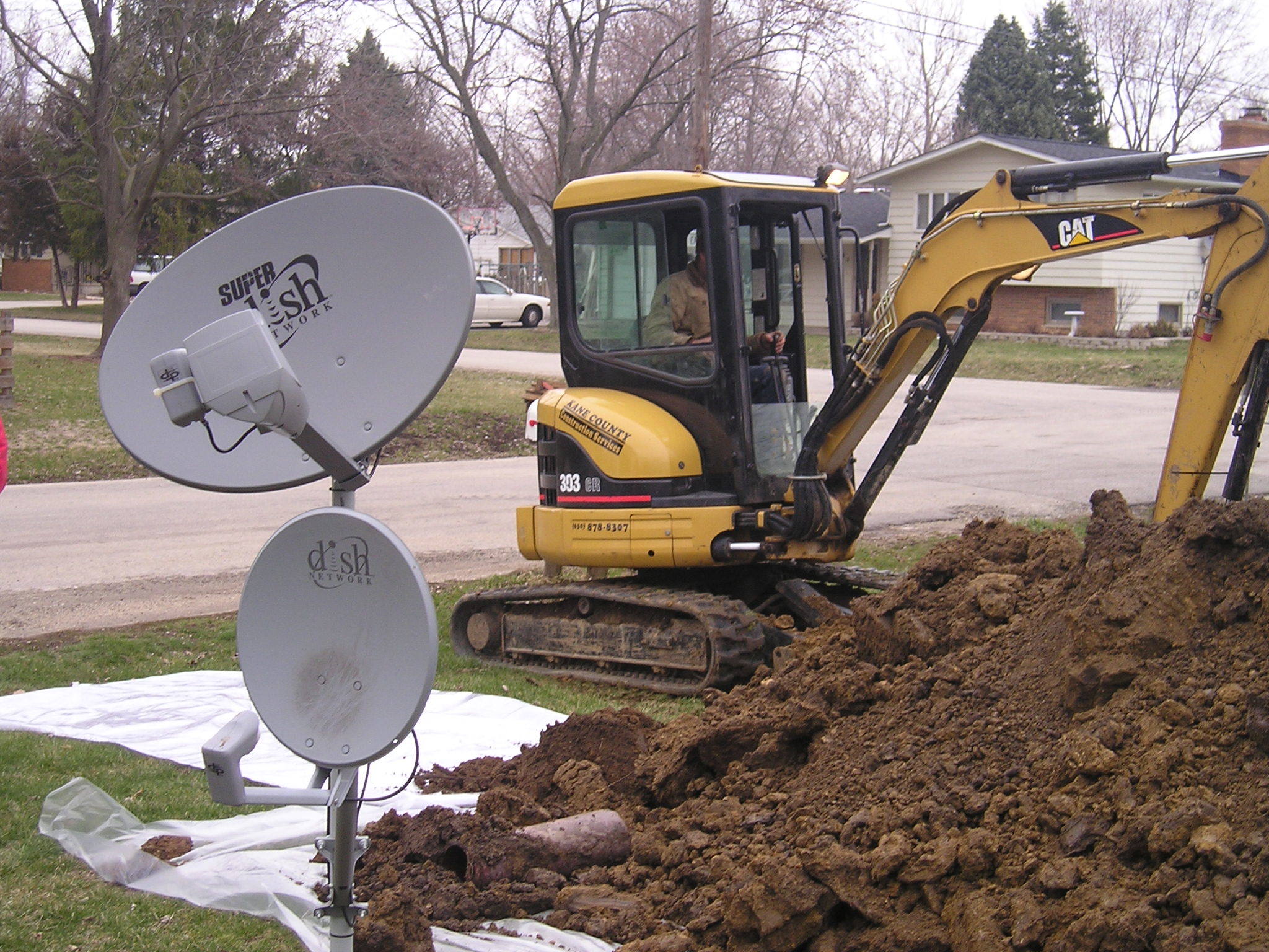

I am using a Dish 300 with a dp lnb, i get 91 on one tp. others in the 60's and 70's here in northern illinois. It is the dish below the superdish...

How do you have the D300 attached to pole using the standard mounting backet? Are you using a couple of U-bolts?

I am using 2 ubolts similar to what is used in muffler shops to attach the dish 300 to the 2" mast which the Superdish is on.
