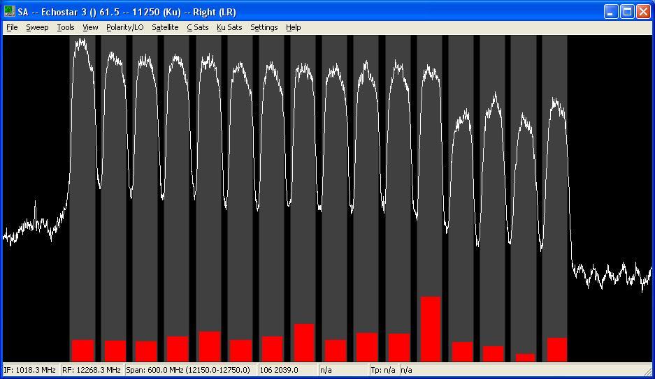

Just noticed transponder 24 @61.5 shows "not locked" with a red screen but a ss
of 106....All transponders even and odd are fine. Is there an issue with this transponder? I did hear there was a possible failure on this transponder...is this
true?? rolou21.

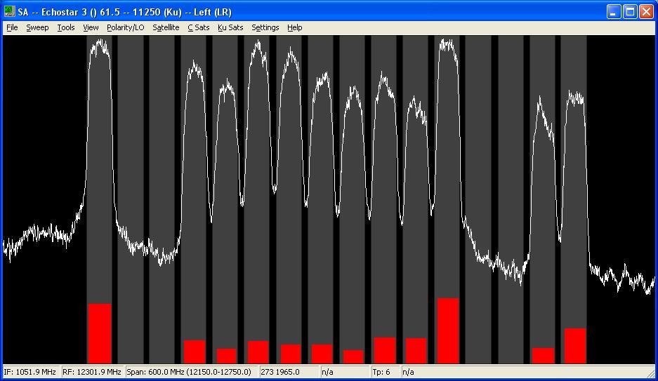

OK, if you insist ;) I'll make new sweep for you today.
BTW, there are many reasons to have high SS without lock: unknown SR to a receiver, SI data not matching definitions in current FW , etc.
[If you have sat feed and PC you could get Broadlogic card 2030 and after adding BLSA subboard to the card do it by yourself .]
EDIT. Added spectrograms. As you can see no SS at tp4, tp6, tp26 or tp28 today.

I am actually referring to transponder 24 not 22....but why is it showing not locked with a ss of 106??? rolou21.
That TP is active and kicking but does not contain any video streams. It isn't mapped in the system so that is why it isn't locking.
