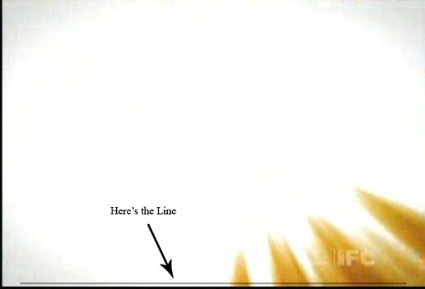

I think the line I was getting is different than the one that most of you are talking about. Mine was clearly within the frame of everything that I had recorded. I've attached a screen grab from one of the DVDs I recorded that clearly shows it against a white background. (You won't be able to see it in the thumbnail view.)
Again, I was able to fix it with a reboot.
Scott

That's the same one I got. My problem with it is that is is showing up on thethings I capture to my pc and therefore is ending up on things I am trying to archive.
