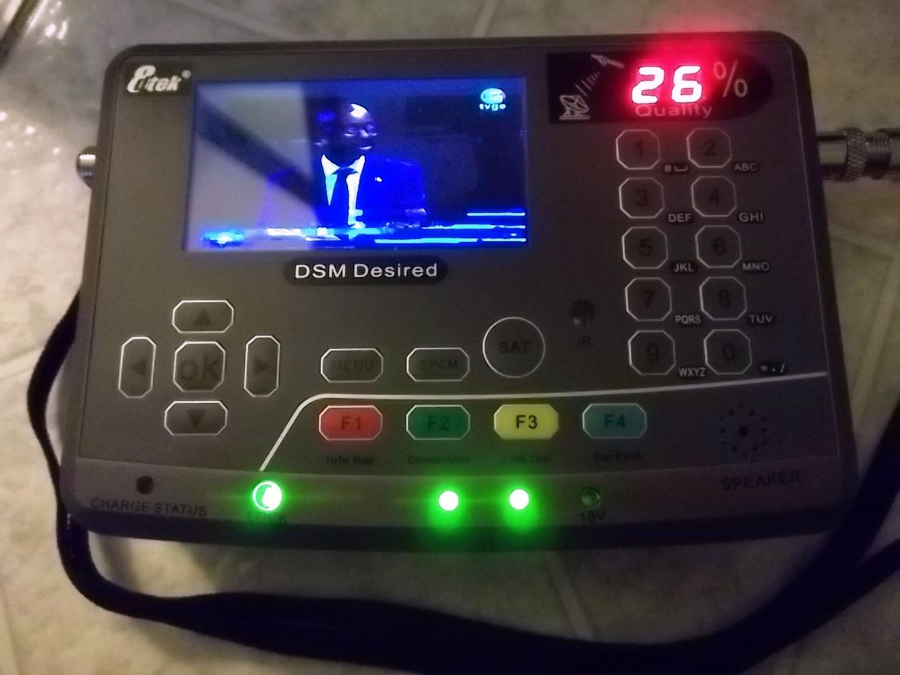

Here a pic of the meter........displayed is TVGE from Telstar 12 Ku, 15W.

Not sure which channels are DVB-S2, so if you know of any will try it out.

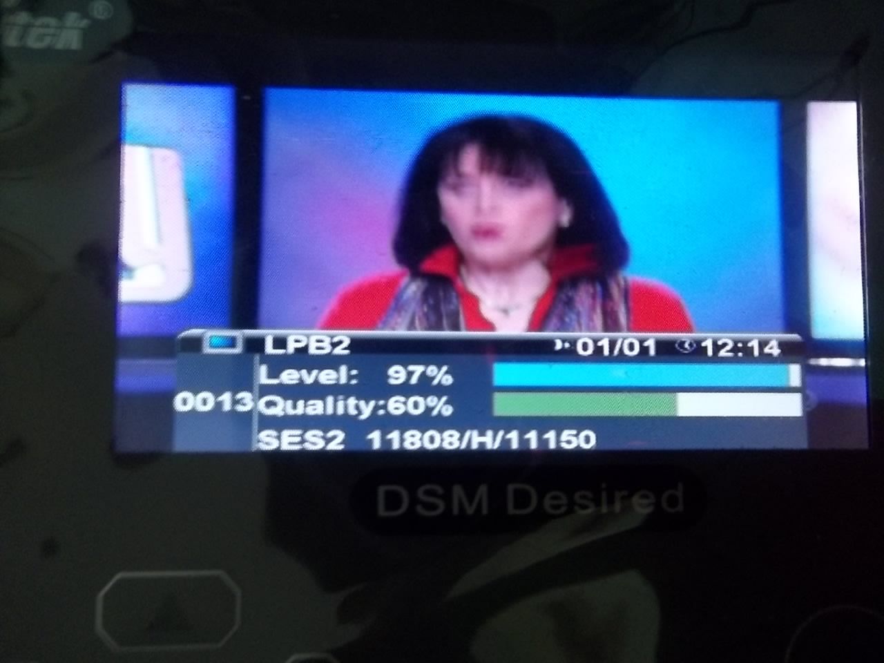

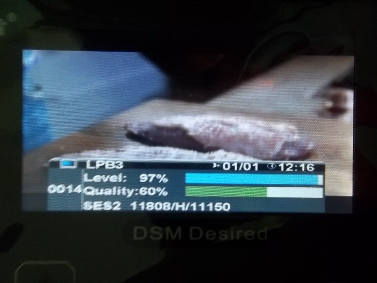

To answer your question, attached are pics of LPB2 and 3 from SES-2 at 87W Ku. No BUD here, just Ku. It does not receive LPB HD channel.
Also shown is the Transponder scan option. Have not fooled with this option too much but it appears you can move the cursor and lock in the frequency. Not sure what happens after that.
Pardon the glare from the protective case. Maybe also be slightly blurry; that is due to my shaky hand and not the meter! It has clear crisp display.

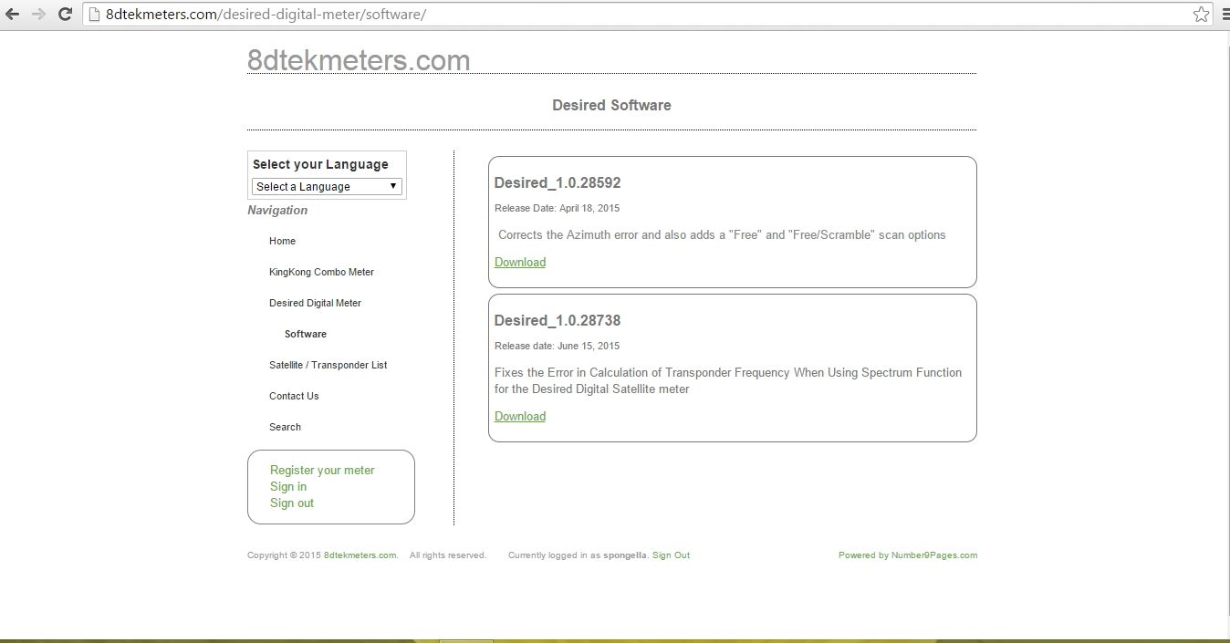

After communicating some suggestions to 8dtek, they have come up with a software update for the meter. It now has a Free and Free/Scrambled Blind scan option, and the meter now shows the correct Azimuth. The update is on the 8dtek website. Have also recommended that the meter show % quality in 1% increments, vs. the 6% increments at the moment.
I copied the firmware to a USB drive, then plugged the USB into the meter.

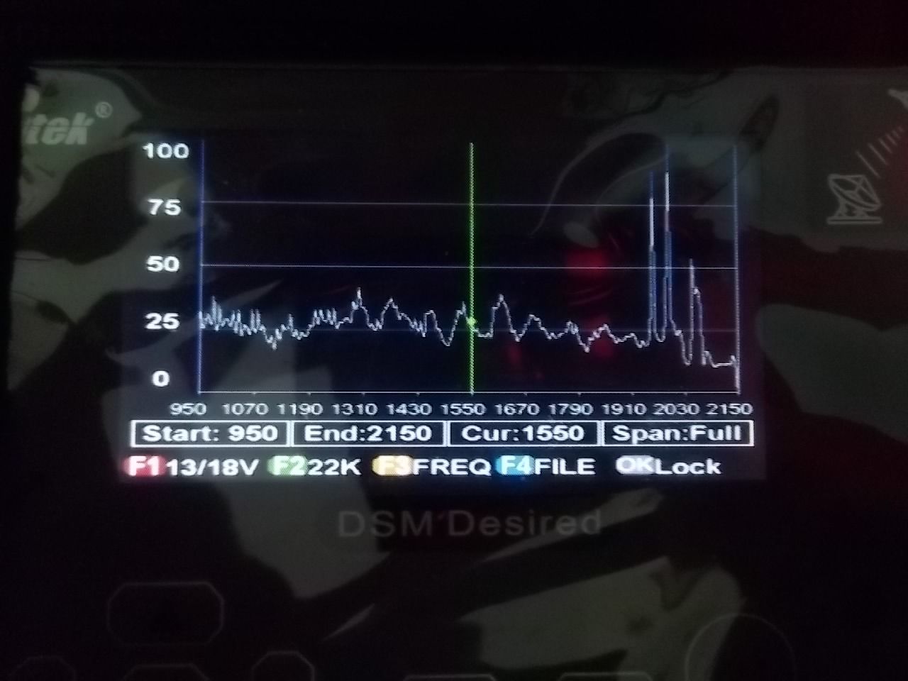

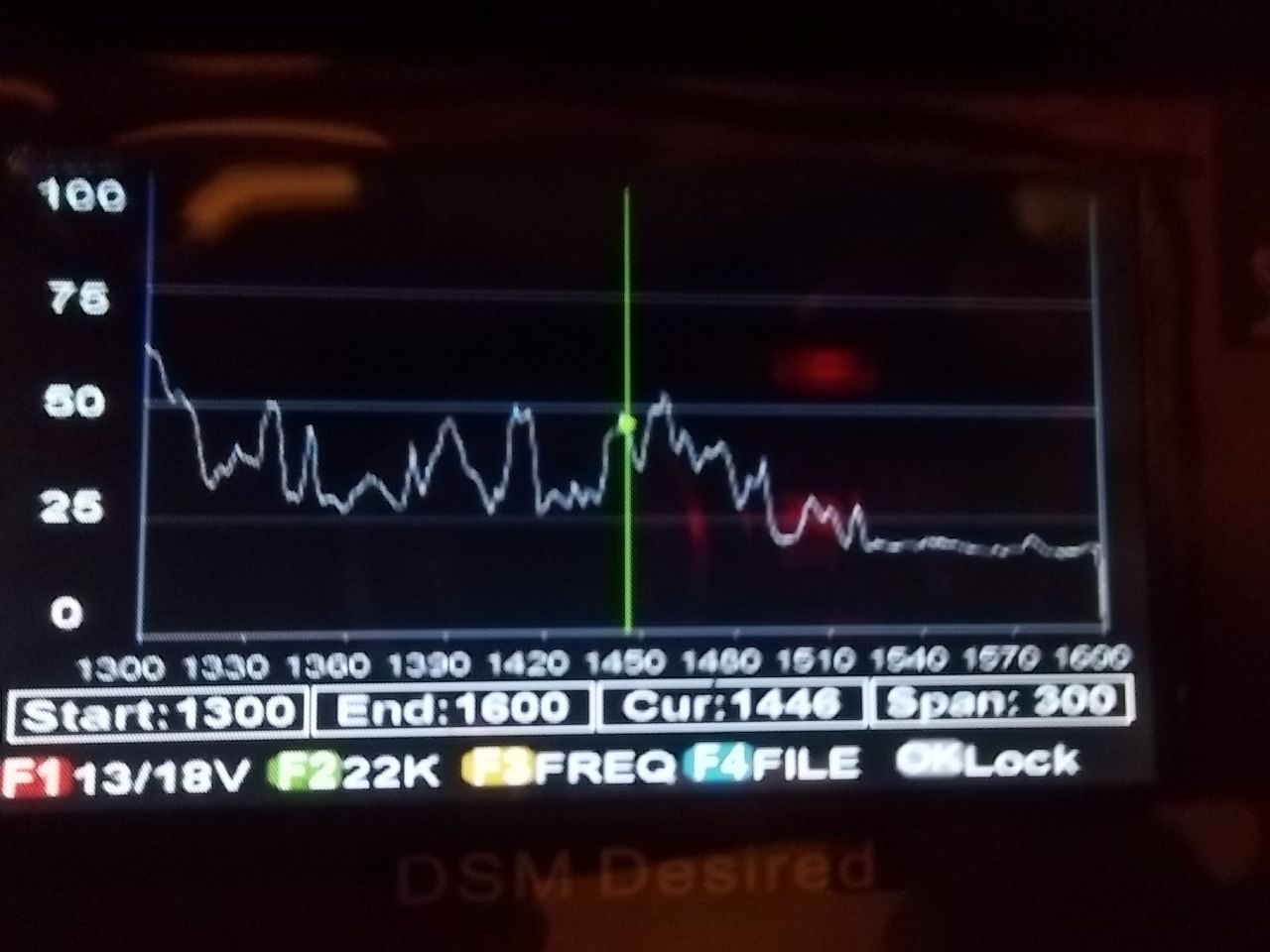

Started fooling with the "Spectrum" function that this meter has, and attached is a pic of a typical spectrum of TPs for a C band satellite, a very nice diagnostic tool. You have the option of moving the cursor to the TP of interest, then hitting the "Lock" key to see if the meter can lock on that TP. What's nice is that you can choose the start and stop frequencies for each scan.

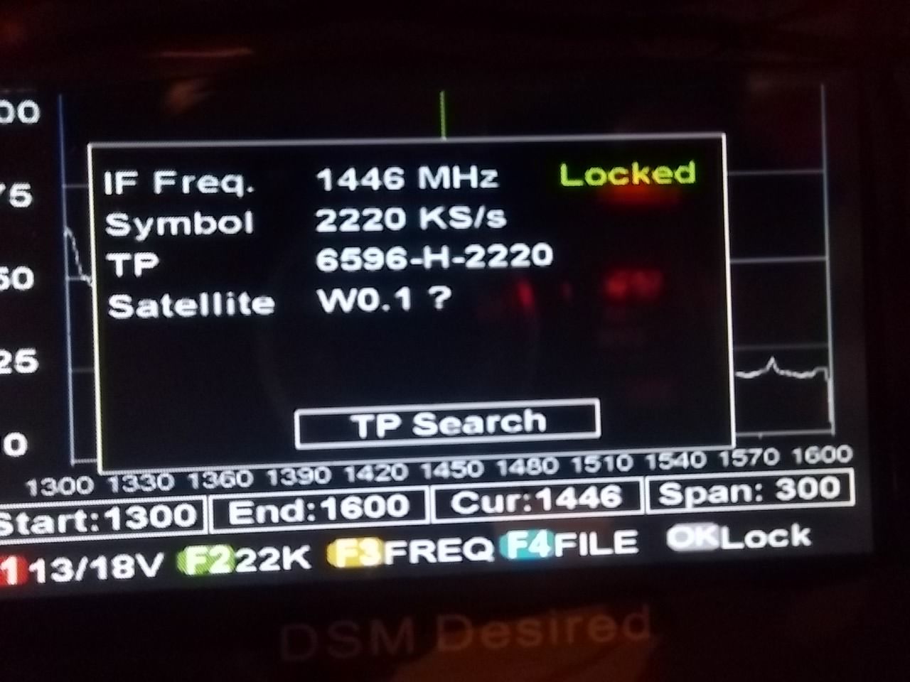

The only glitch is...when it finally "locks" on a TP, see second pic, it identifies the frequency of the TP incorrectly. At first I was puzzled, then figured out that the meter is adding the LNB LO frequency (5150 MHz) to the IF instead of subtracting it, and as a result the meter cannot "lock" the TP. Have contacted 8dtek about this, they are pretty good about fixing these type of things. Might be just a software fix.

Good news for 8Dtek Desired meter owners, they just released a software upgrade that correctly calculates the downlink frequency of a TP when using the Spectral Scan option. Check the 8Dtek website for the 6/15/15 update. I think you first have to register on the website to get to that page. 8Dtek is receptive to feedback from their customers so if anyone out there has a suggestion please forward it to them.
