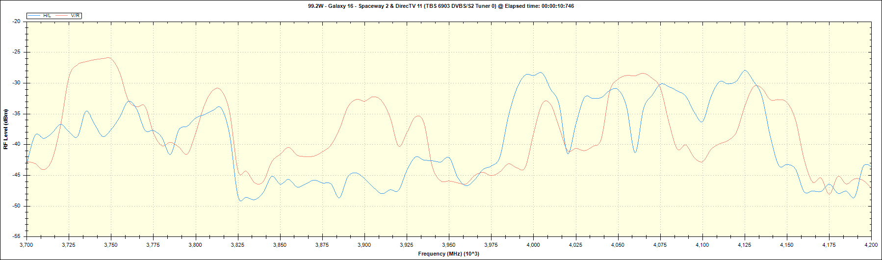

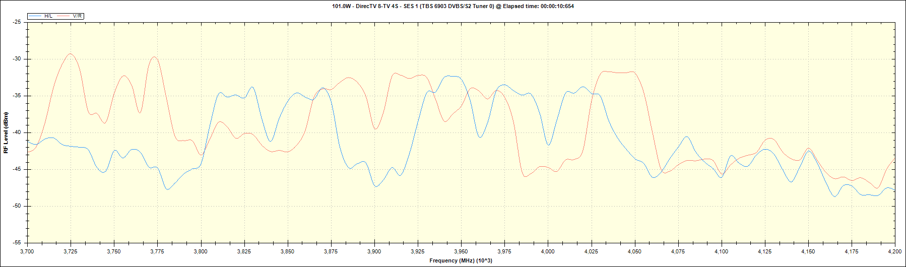

Is anyone else having problems with pr vi mux lately? I seen they have put something on 101w only 7 mhz away from pr vi mux can that cause trouble?

The possibility of interference depends on the bandwidth of the 101w transponder. If you know the parameters of the new TP, use a link budget calculator to know the bandwidth or view the carrier on the online spectrum display at SatSignature. If the frequencies overlap, you will experience interference with an undersized reflector.
101 and 99 scans

TP seems clean here, but with 10 foot reflector..

Brian they have posted the new transponder from 101w on lyngsat take a look at it when you get time. They are also using a symbol rate about 25,000 to 30,000 on ses1. I understand what you said about using an undersize reflector I remember what you had told me about it. Can also someone using a minibud 4 feet and under can someone scan 99w for me to see what channels you can get? Other than the shepards chapel that is the only one i can get on the vertical side only 3 transponders that I can get on horizontal side.
I am certain that you will experience interference from this new transponder. A 1.2M reflector will not be able to attenuate this adjacent satellite interference transmitted in the same frequency range with similar strength.
Like Cham posted, I have no problem or interference with a 10' dish.
