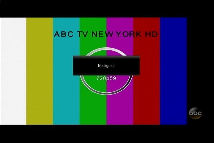

For the first time TODAY, I was hoping to tune on ABC East on Galaxy 16 satellite C-band, TONIGHT!!!
What happen to ABC Network feeds, now????
I got the other digital channels, "Lessor 1, 2, 3, 4, 5. They show I have signal.
NO SIGNAL on ABC
Is it still up there or did they moved, again???

In October I was going to watch ABC East on Galaxy 16 C-band satellite.
I went to it and discovered ABC has NO SIGNAL!!!!

ABC-East - No signal - 4120MHz
ABC-Mountain - No signal
ABC-West - No signal

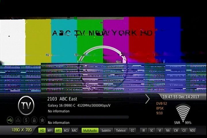

Whenever I have this problem, I tried out with different satellite receivers
to see whether would the out come be the same as with the GEO SAT Pro
receivers.
When I tried with the SKYBOX F3 receiver, PROVEN that ABC Netowrk
feeds is on Galaxy 16 C-band and OUTDOOR CHANNEL AC-3 on
Galaxy 18 C-band satellite.
I might have to try this again with the SKYBOX F3 receiver for the TEST.
