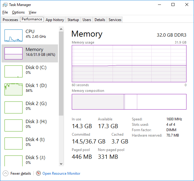

On the host machine, what percentage of RAM is in use during freeze up?
I never really noticed, but I can't imagine it's more than 20-22 gigs. I'll have to check next time it happens.

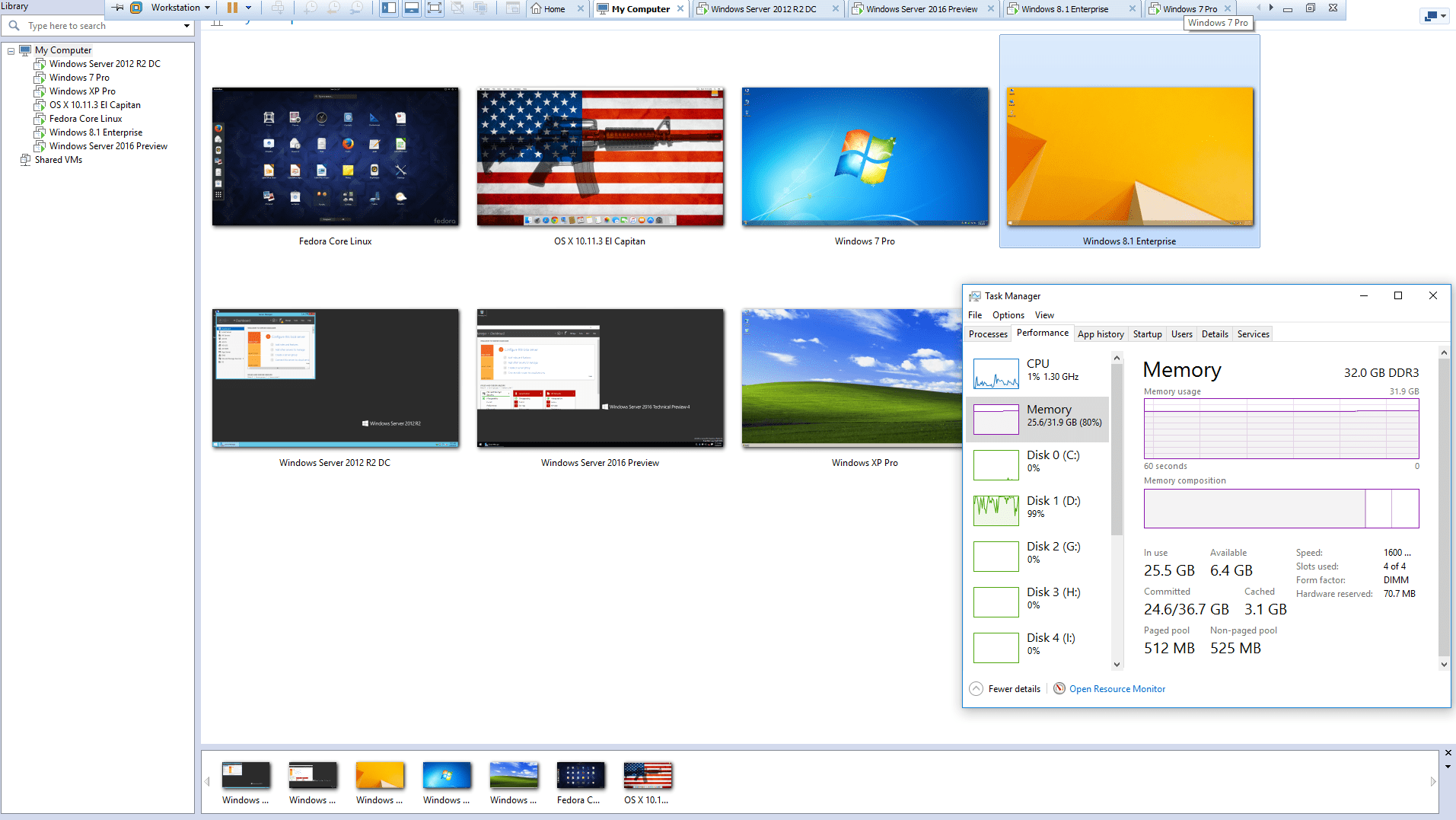

Had a problem with Server '08R2 so I removed it for the time being. Installed Win 8.1 and Server '16 Preview. Booted all 7 up at the same time, logged on and 10 minutes later 100% disk usage and 80% memory usage. While all VMs are slow, not as slow as I would have thought, no freeze ups or total black screens.
80% memory usage
In your first post I was a little concerned regarding memory allocation between host and VMs vs total memory. Best practices say anything over 80% sustained memory usage is not good, and additional memory should be added. So you are right on the border line.
If you fixed the lockup situation with 'Turn off Display' and power options and you are happy with the slower performance, than you may be OK with it for your purposes, especially if you don't plan on running all hosts all the time.
Good catch by the way on the display and power options!
Turning that stuff off is the right way to go when having strange issues.

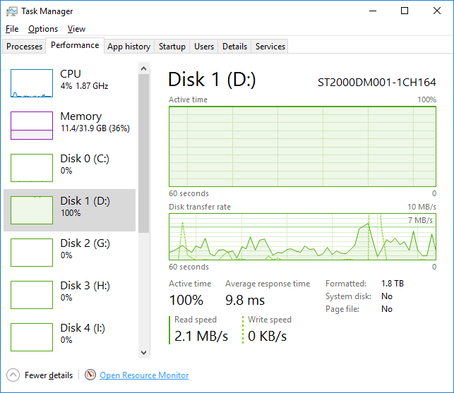

Is the disk usage a constant 100% all the time?
Sorry for the delay. Been a fun week so far at work.
Disk usage is at 100%, or close to it on my D: drive pretty much the entire time I run VMs. Right now I have three running and it's been pegged at 100% almost the entire time. I was thinking this was normal, on second thought, I'm guessing not?

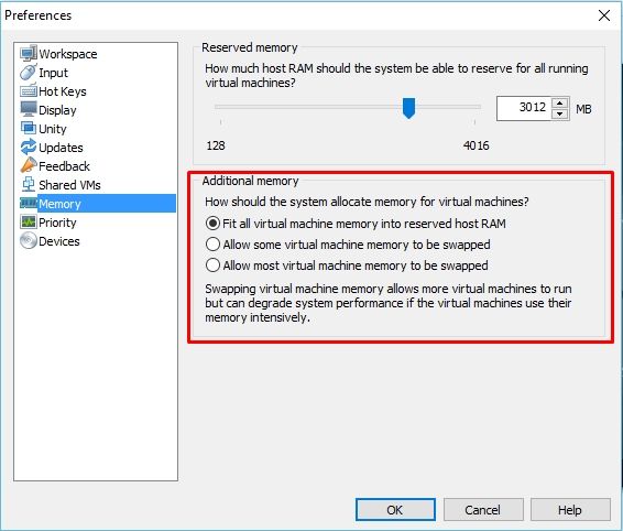

Probably you are swapping memory out to disk too much.
https://kb.vmware.com/selfservice/m...nguage=en_US&cmd=displayKC&externalId=1008885
Read to the section:
Edit the virtual machine settings to reduce I/O usage by using more host memory
http://joshrobi.blogspot.com/2012/04/fix-for-excessive-vmware-disk-activity.html
Maybe try this first as in the second link:
https://www.google.com/search?q=vmware+100%+disk+usage&ie=utf-8&oe=utf-8
NOTE I am not down in the trenches as a system admin anymore and cant verify location of settings on a newer live system, but the principles are still the same.

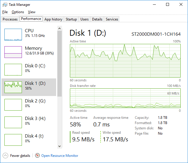

I Googled it as well, and came to an article where someone mentioned that decreasing the processors helped his situation. I shut down the virtual machines and edited the properties, and went down to 1 processor with 2 cores still. It did seem to help, but as you can see it's fluctuating a lot, it's just not pegged anymore. Server 2012R2, 8.1 and Server 2016 are booted up, and Server 2016 was installing what appeared to be a massive update.
After the update, and reboot with everything idle.
Never the less, I will looks into the settings you mentioned and report back. Thanks again!
