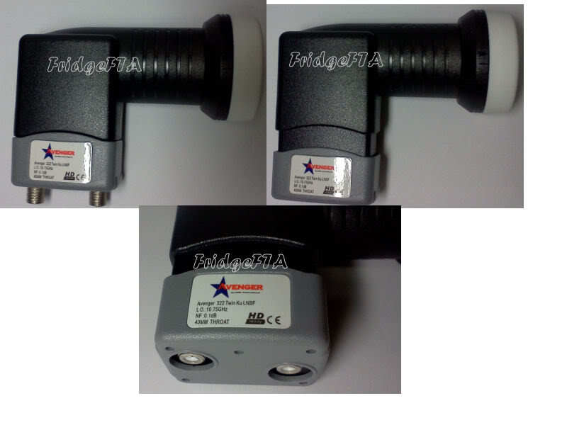

I've read on reviews you can slide down that little grey cover over the connectors. Has anyone tried that?http://i1200.photobucket.com/albums/bb334/joef1/avenger322cover.jpg
There ya go, that's the image I was trying to embed...didn't work through my phone, sorry!

I'm using two of the Avenger on my Prodelin dishes and they seem to work OK, but I probably won't buy anymore as I purchased a Xtreme II LNBF and I like the way it's build as its all metal construction and fits the holders that I'm using better, so when needed I'll most likely buy more of these. And best of all it's easier to get to the connector when installing or removing a cable as the Avenger hides part of it and you could have problems removing a cable, been down that road already as it cost me one of my original three Avenger that I had.
Thanks for mentioning that. How exactly does it limit access to the connectors, though? Couldn't you just slide the grey part up again and have complete access? I'm gonna check out that xtreme ii, never heard of it!
If you look at them you'll see that the housing comes down over part of the connector so you can't get to the nut part of the connector in case you over tighten the cable. That what happen to me as I put on a small section so I can hook up my FS1 and when done us a barrel connector. When I was hooking up my meter I didn't realize that the cable was also turning and it may have tighten itself or when they build the LNB they didn't really tighten it before attaching the the board as it took very little to destroy it and I only finger tighten.
