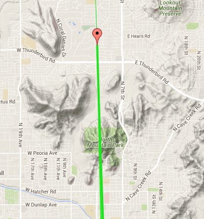

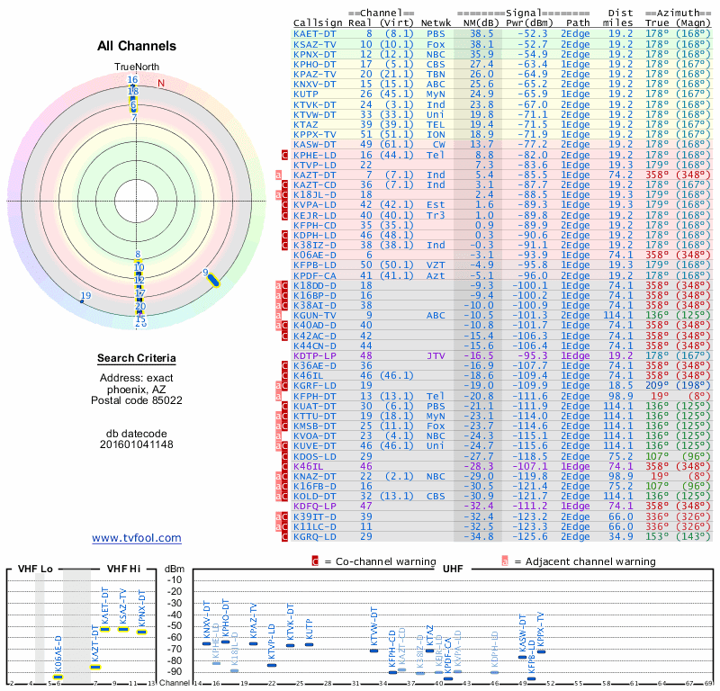

Does this report deal with line of sight issues?
Seen in the Path column. Does not account for buildings and trees or any other local signal obstructions.

The 1EDGE and 2EDGE entries indicate that the signal has to diffract around the hills.
It looks like some sort of "attic antenna" will do fine then - all the channels she wants are in the green/yellow. Any recommendations for an antenna? I guess It will be mounted outside, either on the side of the house or perhaps a tree (those useless tall palm trees might come in handy after all!).
While there are a lot of two-edge scenarios, most of the power figures are within range (<75dBm). I would recommend a directional antenna as you may find that you need to point to one side or the other of the hill to get optimal performance. Multipath (bouncing off the hill to the west) seems likely to be an issue so a narrow reception angle is probably important (a high front-to-back ratio probably won't hurt either).
