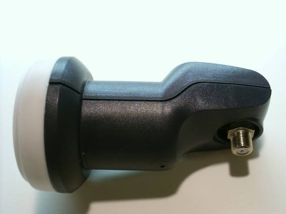

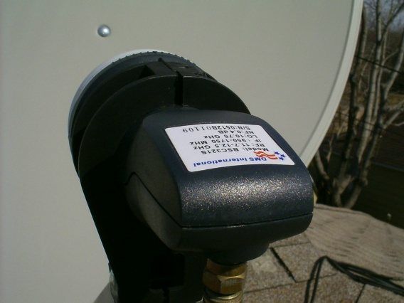

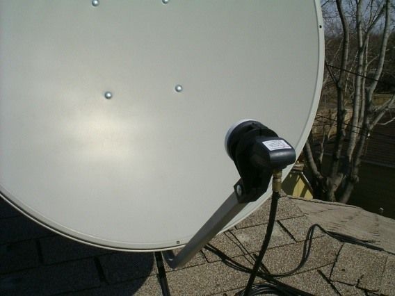

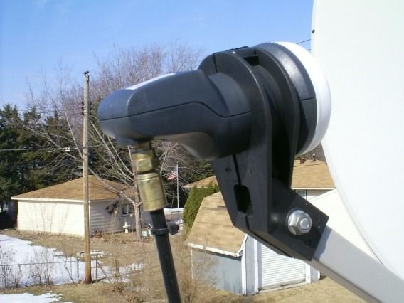

BSC321S 0.4dB US Standard Single Ku LNBF

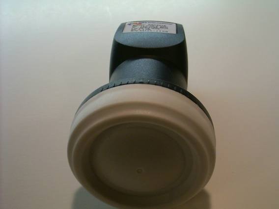

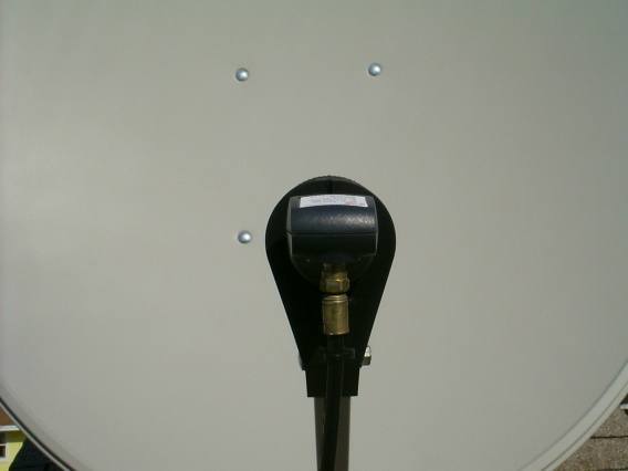

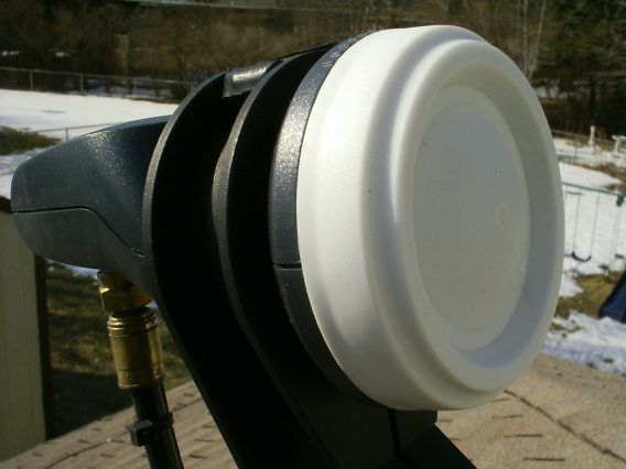

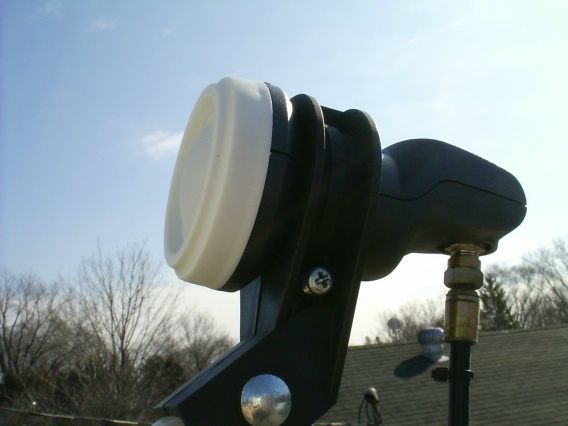

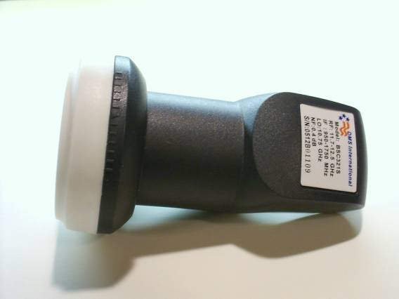

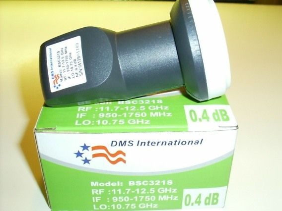

Just got a chance to test out this great new "mini" (4" long) LNBF!
Its very comparable with the best LNB's out there as my comparison test below shows.
Its very light and would be ideal for people with LNBF weight issues. Its a Standard KU LNBF so uses 10750 as the L.O. setting, and its just 0.4dB noise level.
Very impressed with its performance when I put it up against the linear side of my Invacom QPH-031
......................./ Invacom / BSC321s
IA-6
News1 LIVE / 88% / 85%
University N. / 75% / 80%
Azteca 7 / 88% / 88%
AMC-1
Pentagon / 60% / 60%
G10R
Tube/Retro / 40% / 40%
WGMU / 55% / 55%
Hispasat
Saudi TV1 / 66% / 66%
Cubavision / 64% / 70%
Model: BSC321S
RF :11.7-12.5 GHz
IF: 950-1750 MHz
LO: 10.750 GHz
