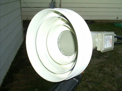

1. Would there be a problem if the lnb is positioned for an offset dish?--i.e.would this effect the reception of the C-band signal?
2. I have Coolset 4000 Pro-do I need some type of switching mechanism to swith bewteen the two different bands?
Thanks
1/ BEST to use a conical Feed horn with an off-set dish. But many don't.
2/ The BSC621-2 C/Ku has its own internal DiSEqC switch!
