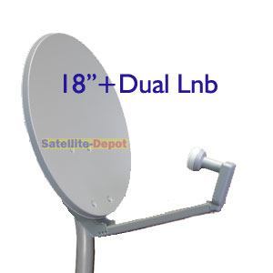

My friend has an HD Dish subscription with three receivers. He's using a DDP 1000.2 dish now.
He wants to move one of the receivers to a distant out-building on his property. He (actually me, doing it for him) will be moving a "vip211k" model receiver to the building.
For this new out-building setup, I will be using an array of three "old-style" dual-output lnb dishes to tune 119W, 100W, and 129W individually. These three identical dishes have been used successfully in DTV and DN setups in the past.
My question:
What type of switch will be required to combine these three dishes and send the resultant signal to the receiver (vip211k)?
From what little I have gleaned so far, I think I will be needing a SW64. Is that correct? And if so, will I need to "insert power" to it? Or will this one receiver work without the power?
Thanks for any help.
Now, I realize there are many other "cleaner" antenna setups that would work, but I'm only interested specifically in solutions that utilize these three individual dual-output lnb dishes in an array, as described above.
Thanks!

the ones you are using are most likely legacy dual lnbs as opposed to dishpro dual lnbs
you will need a sw64 with its power inserter to link all 3 with 2 lines from each lnb

Thank you, TimberWolf. All three of the dishes were originally DTV equipment. I assume they would be the same/equivalent of "dual legacy" lnb's, correct? I'm only familiar with term "legacy" (this-or-that) being used to describe Dishnet-branded antennas, so I'm just not sure these are the equivalent. They look exactly like the picture I attached: 18" dish, with a single dual-output lnb, and they definitely are from DTV setups originally. Later, they were used (two of them, in an array) to tune 110W and 119W for Dish (using a DiSEqC switch).
It's just that before I buy the SW64 switch (seems kinda expensive to me) I want to have a little more confidence that I've got it correct, and that's for sure what I need.
Thanks again!
the old direct lnbs and legacy dish lnbs are functionally the same. dish only came out with the legacy designation when the started producing dishpro equipment
if you can't find a cheap sw64, it may be quicker easier and cheaper to find another 1000.2 dish
sw64 switches weren't known for durability
The dishes are compatible but the LNBs might be different. The old LNBs were compatible with Dish Network, but the later ones are not. I am not sure of the details, but maybe Iceberg or someone else will help out.
Edit: I guess TimberWolf typed his answer while I was typing this. BTW, I agree that you would be much better off with a 1000.2 dish.
