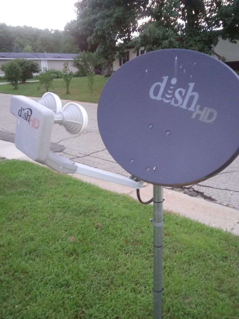

Hello, I just moved into a place with a "Dish HD" dish in the yard and I wondered if it could be used or modified for FTA (I think it's called Ku band, galaxy 19 etc) or if I need a new dish. It has 2 LBNs. Also below Ive included links to a receiver I'm considering and a dish I thought about getting if this one won't work, but it would also need an LBN. I'm open to any help or suggestions, as I'm new at this.

While it is possible to convert that dish for FTA use with a lot of work, I wouldn't suggest you put yourself through that ordeal. Once you know about the way everything works then you can apply your knowledge to projects like that. :) The Winegard dish on eBay is a good choice for a beginner. You will also need an LNBF. ( LNB with feed horn built in) . The receiver is a poor choice. Aside from being used, it's out dated and no help available. And no remote! It's worthless. There are other cheap china receivers on eBay but support is usually nonexistent. Even the dealers don't know anything about them :(

The hard lesson that I recommend everyone avoid is that a relatively small dish is not your friend. The DISH HD dish and the larger DIRECTV Slimline are simply too small for FTA enjoyment and fitting them with an FTA LNB is a rather tall order that, because of the lack of gain of the dish, won't be very satisfying other than as an art piece.
There was a time when I reasoned that I could record video on C-type cassettes but thanks to Fisher Price and their PXL-2000 video camera, I was saved the frustration. As Magic Static points out, you want to be able to get results after going to all the trouble and the DISH 1000.2 is about half of the dish (area-wise) that you need for reliable FTA on the most popular satellites.

As for the dish, yes size is important and I would recommend a 90 cm too. But that's not to say that you can't get started with what you have. I would say it also depends on your degree of enthusiasm about FTA... If you like tinkering with less than perfect solution for the fun of making it somewhat work and accept that it's not perfect, then you can give it a shot. But if you have higher expectations and will get discouraged if it doesn't work as well as you were hoping for, then don't bother.
Fortunately you have the old LNBF assembly so you can tell exactly what the correct position of the LNBF should be. You can get an adapter and a decent LNBF for about $20. it won't be "plug and play" but if you position the new LNBF so that its opening is positioned similar to that of the old Dish Network LNBF it should work ok. It's still on the small side, and on 97W some transponders will suffer from interference from 95W and 99W. It would probably work ok for the CCTV/CGTN channels on 95W. Also, you will probably lose reception during moderate to heavy rain.
So by all means, if you can afford it, get a 90cm dish (about $100), but if your budget is limited, the dish you have is better than nothing as long as you don't expect miracles. That's how I got started, with an old DN dish that was on my house when I bought it.

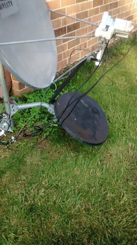

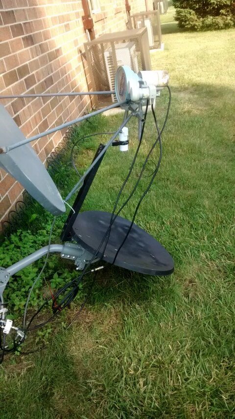

This dish works perfect for 121w. Since you have the original lnbs measure the how high the center of the lnb is and the distance from lnb to the pan. You can purchase a 5 $ bracket or use plumers tape with tye wraps to mount the new linear lnb for fta. I get 84% signal off that bird. And should work with most others. Good luck and have fun.
Here what mine looked like, but for newbies get a 36 inch dish, ku band lnb standard, amiko receiver.

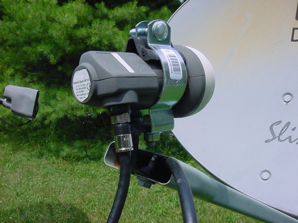

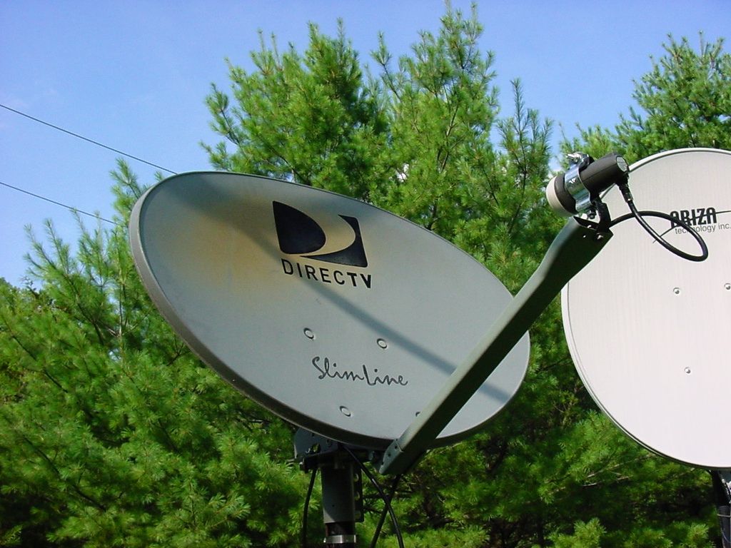

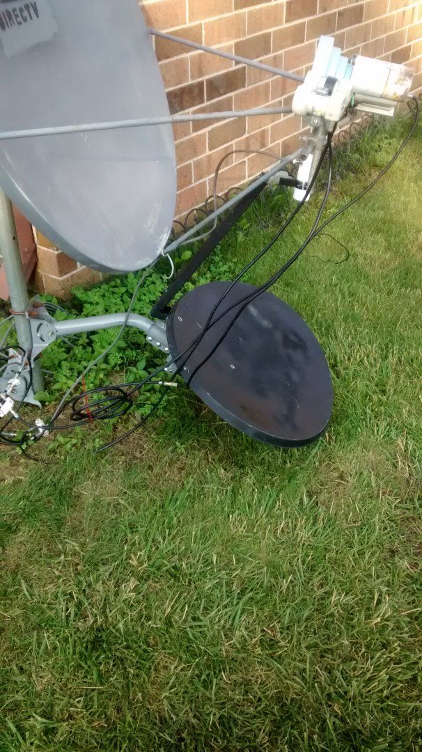

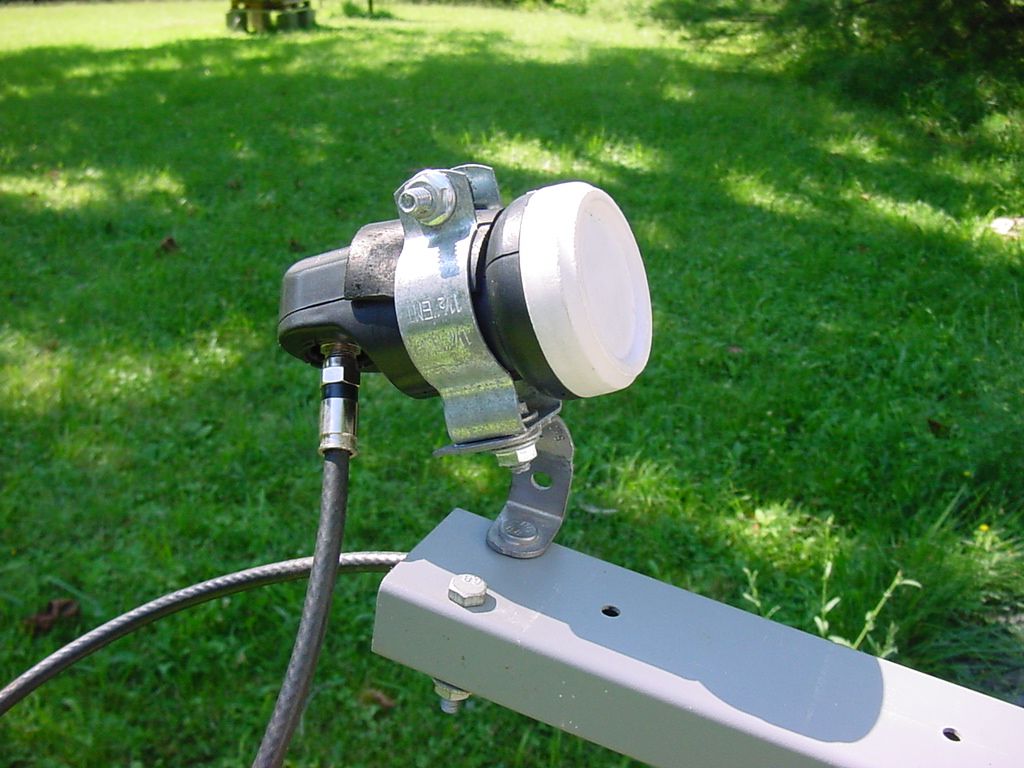

While I agree with the other members about starting out with a dish that is too small is probably not the best approach, it certainly is possible.
Keep in mind, I have been pointing satellite dishes since 1988, I have a barn full of all sorts of dishes, I have a nice meter for aiming and experience to know what I can receive from where.
Some examples provided of recycled dishes with fabricated LNBF holders here out in the yard. While I have an extensive supply hardware and metal odds and ends, universal LNBF holders are very inexpensive from many online sources.

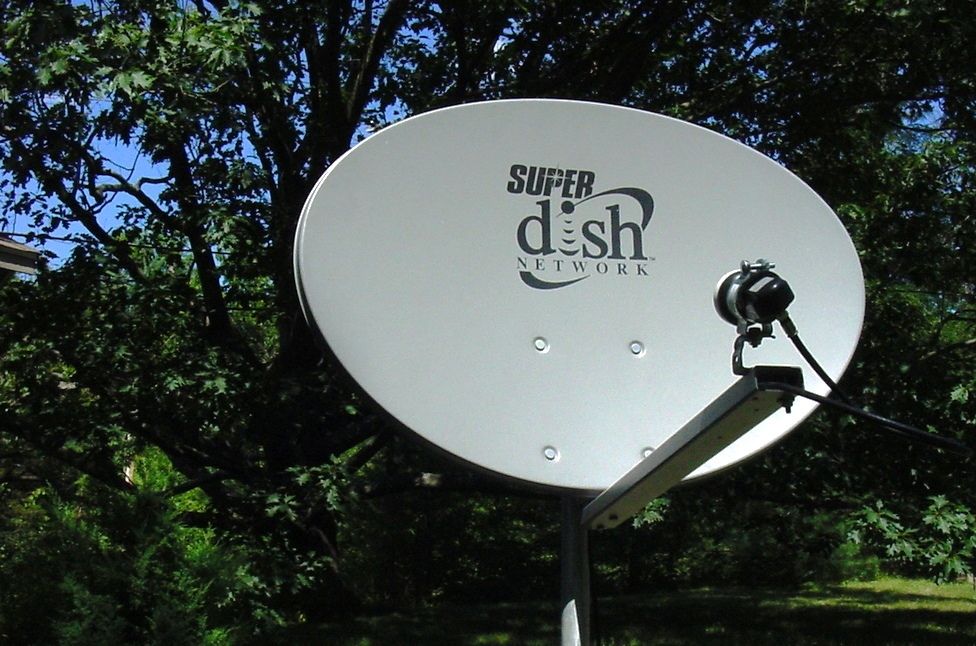

i'm currently using a Superdish on 123W, with its original mediocre stacked LNB, and it's giving surprisingly great results on KBS, but borderline for TVW. But KBS is stable unless there's a real bad downpour. I use another Superdish with a universal LNBF on 34.5W for the handful of French FTA channels, and it's mostly fine but degrades quickly at the slightest rain. I should replace that one with a 90 cm. I was actually surprised that it worked at all with the superdish.
