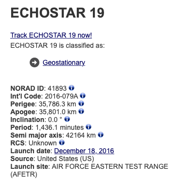

Bobby if I understood well he wants to get EXIX:
Guess he is going to get broadband? I really don't know, but if he really just wants the Western Arc the best option would be the 1000.2 as you suggest:
