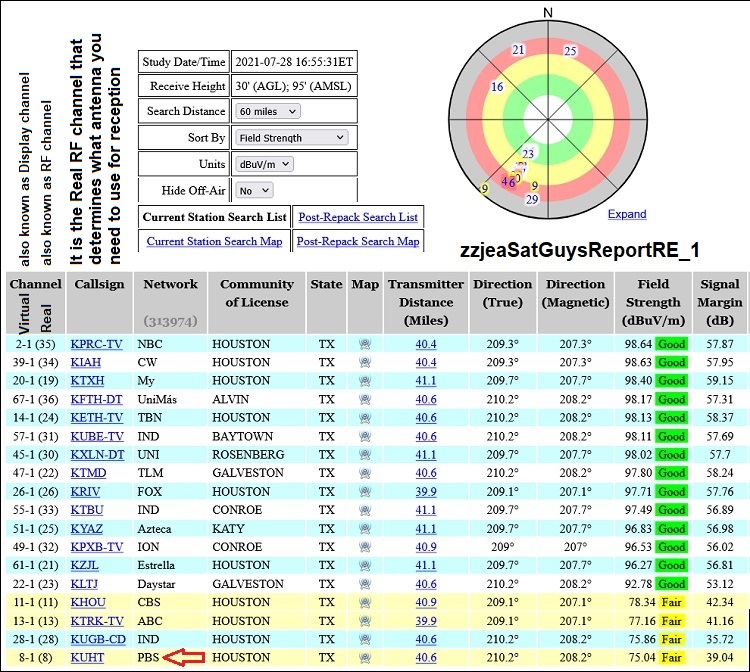

On the Rabbitears chart the number after the XX-1, in parenthesis is the frequency, so channel 8-1 broadcasts on VHF channel 8.
ABC and CBS are also VHF, on channels 11 and 13.
At 40 miles you are probably fortunate to receive channel 8 on the other antenna. You need to get those antennas out of your attic and up in the air.
Rough estimate for attic signal loss is about 50%, so it is equivalent of already having a splitter installed, maybe worse depending on roofing materials.
Here is a chart of USA TV channels and the associated frequencies. TV channel frequencies | VHF,UHF TV channels 2 to 69
Please note that most channels do not use the same RF channel as they use as their call sign, for instance NBC in Houston is channel 2-1 but broadcasts on channel 35 RF (radio frequency). Digital TV introduced these virtual channel to us. All this information is in column one of the chart Rabbit Ears showed and you duplicated in your post.

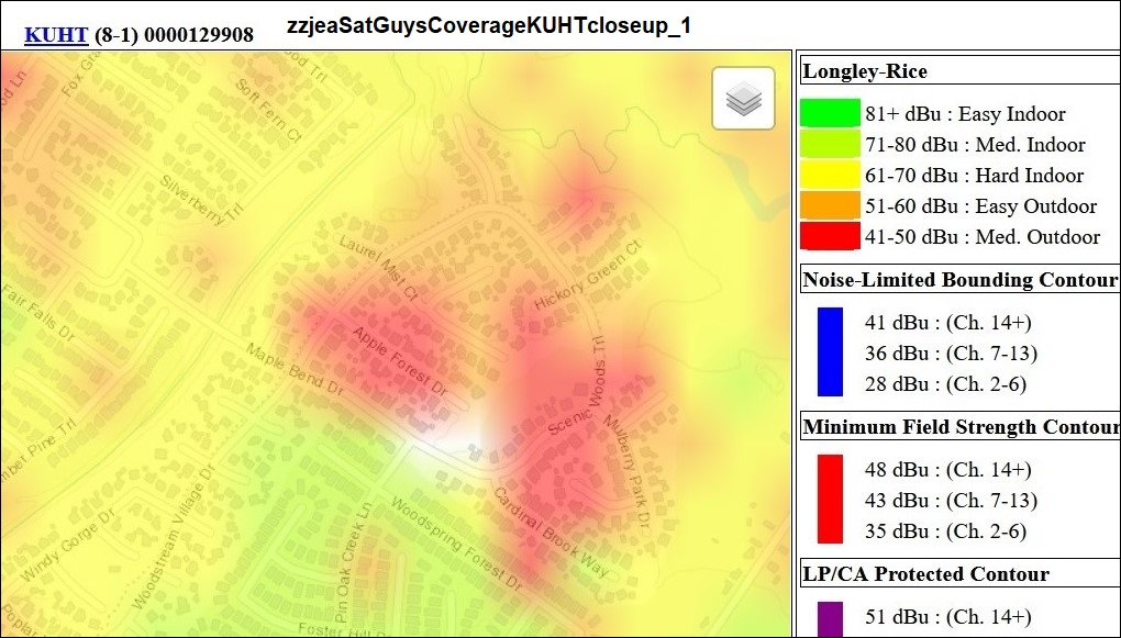

PBS is a little weaker than ABC and CBS. As Jim mentioned, the signals in the attic will be weaker than listed on the report. Also, any trees outside in the signal path will make the signals weaker.
Thank you for the signal report.

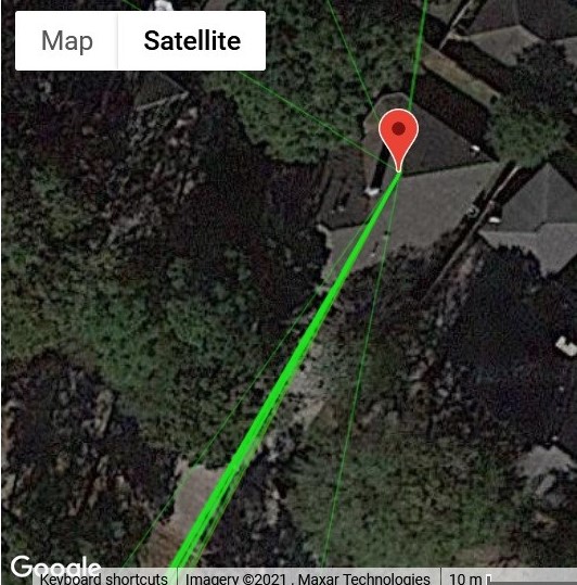

You are in the area of coverage for KUHT, but there are some weak signal spots around your location. I have removed the marker for your actual location.
I don't know how to delete this:

Just trying to understand why this one channel is missing. It shows as Fair from my location, but so does ABC and CBS however they may be UHF.
ABC and CBS are also VHF.
ABC is on Real channel 13 (210-218 MHz) and CBS is on Real channel 11 (198-204 MHz).
The yellow background on the report for those channels indicates VHF-High.

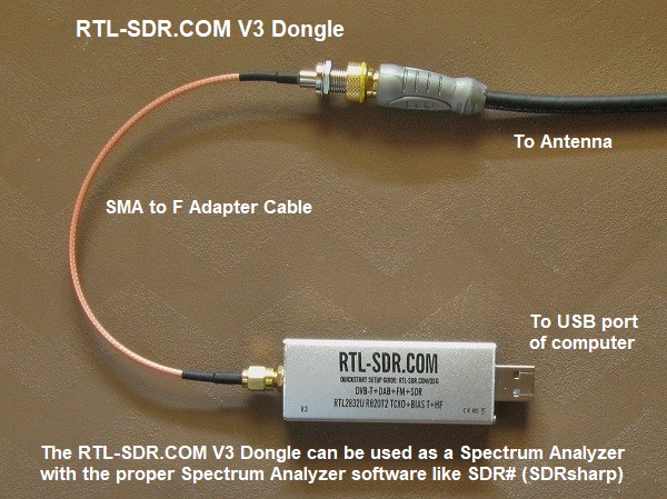

If you use an SDR, you can actually see the frequency of a channel. The least expensive SDR is the RTL-SDR.COM V3 (about $30).
Buy RTL-SDR Dongles (RTL2832U)

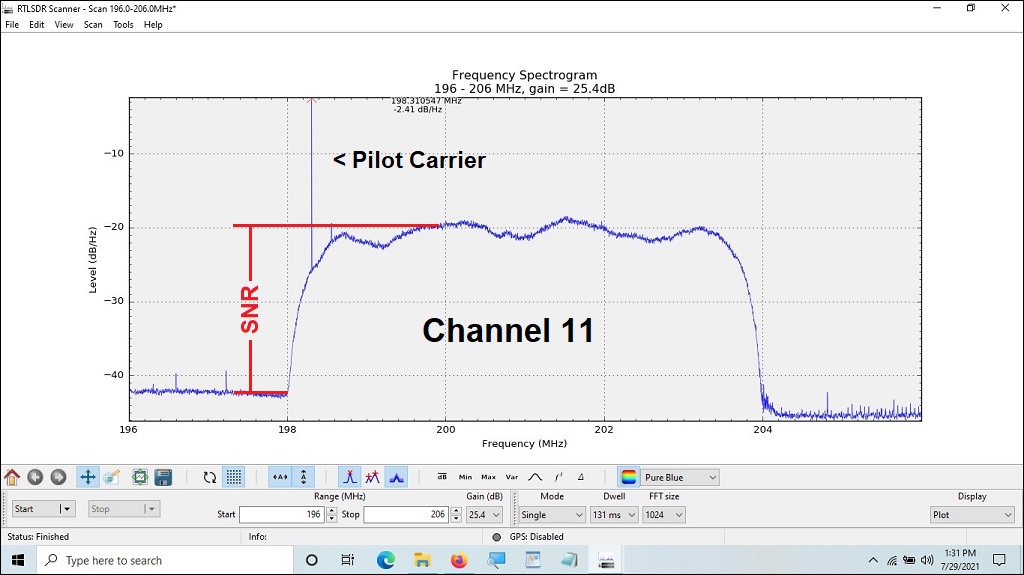

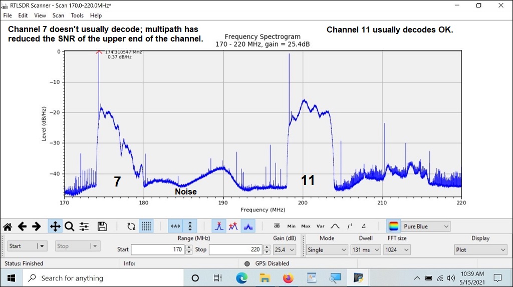

With it and DIY free software from GitHub you can see VHF-High:
or just one channel:

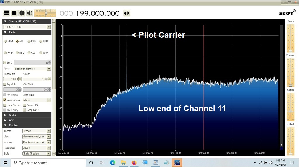

If you don't want to mess with the DIY software, you can use SDR# (SDRsharp) software, but you will only be able to see about 2 MHz of a channel at once:

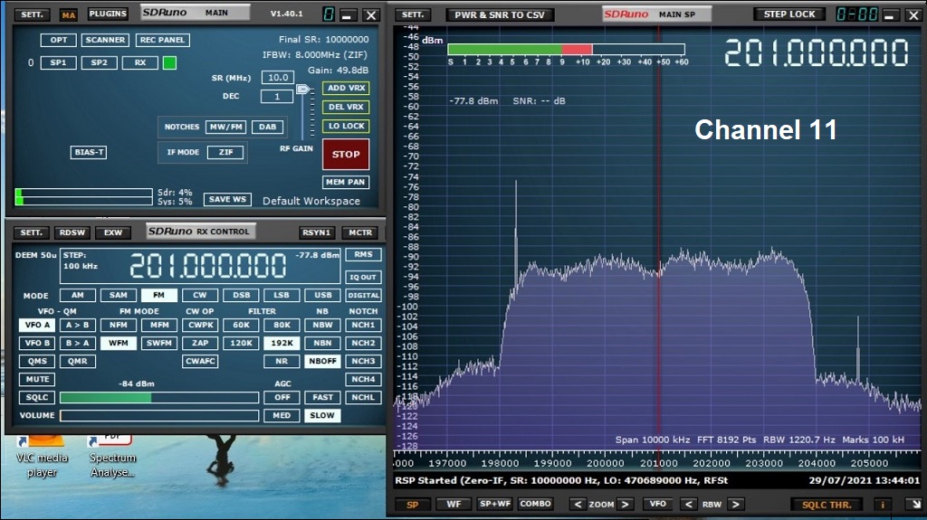

If you use an SDRplay RSP1A SDR ($100) and SDRuno software, you can see a whole channel:

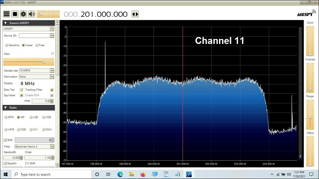

If you use an Airspy R2 SDR ($200) and SDR# software, you can see a whole channel:

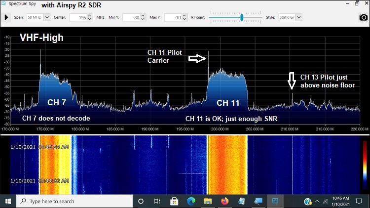

and with the Spectrum Spy software you can see all of VHF-High:

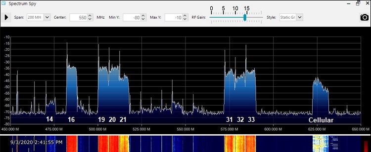

or all of UHF:
