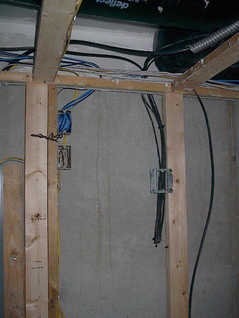

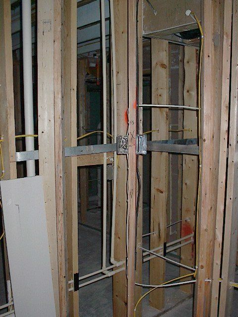

Thanks, I might consider that. With me, it's the fishing behind drywall, at least somewhat. See my attached pictures. It looks like there is only one staple / tie holding the cable to the stud, at the wall box and at the distribution point. Overhead, the cable is loose. So if we could just get those two staples removed (just yank the cable?), we can pull the existing cable back through with a line tied on it, which we pull back with both cable runs then. Doesn't seem *that* hard, does it?

Also depending on the type of staples used, one of two things will happen: You'll either pull the staples out when you pull on the line; OR you'll rip the line in two. If they are the big 1/2" metal brads you'll most likely rip the line in two if you try to yank it out that way.
