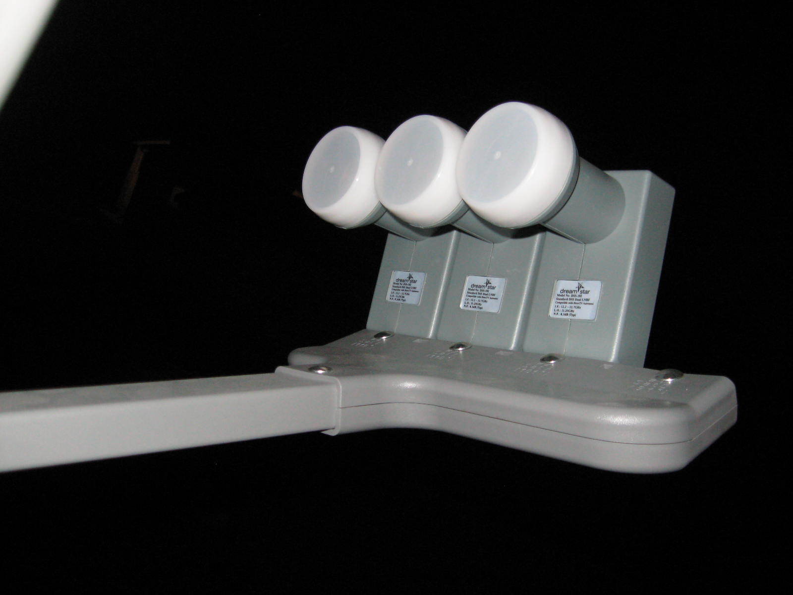

Sounds like your receiver doesn't know how to control the DiSEqC switch. What LNBs are you using? If Dish Pro, you could fix this with a genuine Dish DP34 or DPP33. If legacy LNBs, then an SW64 should do the same thing.

Find attached picture of LNB's.
