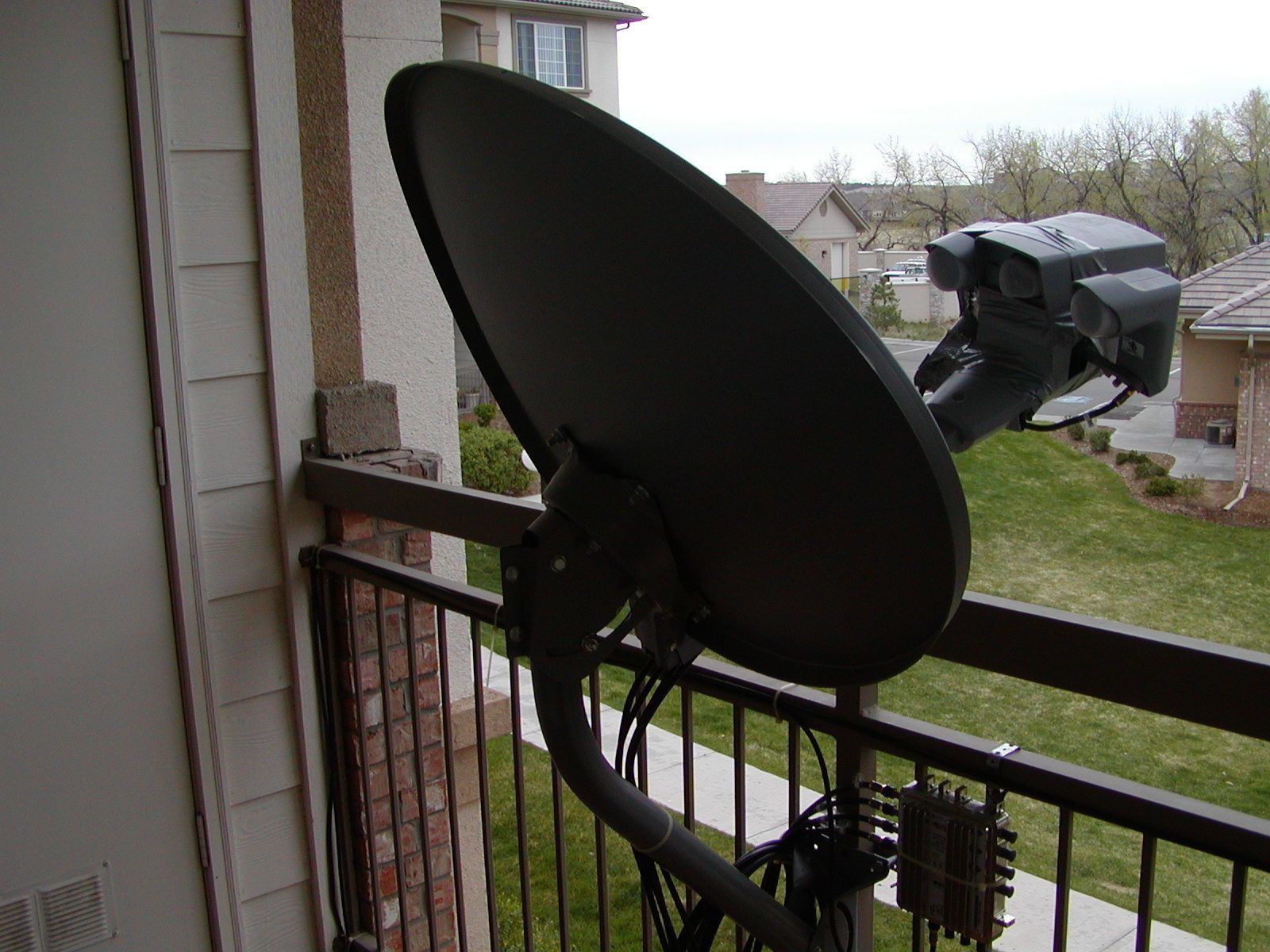

(2) Or you can go even easier than than. Well before Team Summit, I knew there was going to be a 4 orbital location dish coming out, but did not know which birds. While waiting to find out what new toys would be available, I bought a DP Dual LNBF and I-Bracket and duct taped it to the side of my SuperDish 121. Just before taping, I held it against the side of the shroud (121 side) and moved it to find the best signal. I then taped it.
---I could use spaces for a slightly better signal, but not worth the time.
---The duct tape may need tightening every 6 weeks.
If the Repoint Kit is not available soon, I will either buy a Dish 500+ and use my extra DP Dual LNBF to make it a 1000+, or cut me a couple of pieces of rectangle pipe (arm from a Dish or DirecTV) and make a permanent bracket.
Here's the picture.

I don't know what adjustments would be needed to remove the cluster from the SuperDish 121, and replace it with a "single DP Dual LNBF" or even the "Dish 1000 LNBF Cluster". Let us know if you try it.
