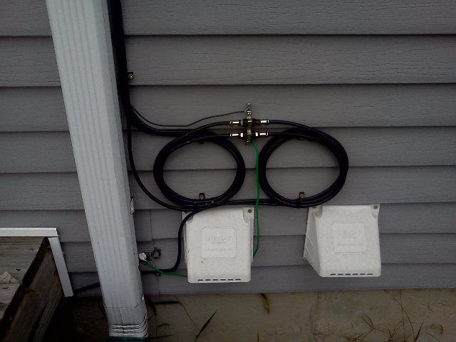

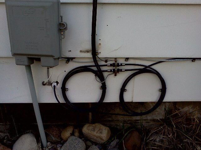

The tech wont have a box for the ground block. I don't know of one big enough to make the loops that Directv requires anyway. If done properly they should be attaced and not look bad anyway.
