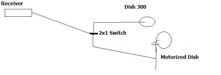

This is my setup...see attachment
I get NASA and ANGEL fine
Lets say I start at IA 5 and move down to IA7 works fine until I hit 119 then when I go past it to G10R and go to the G10 channels I get nothing... keep changing channels it then moves to IA 7 and White Springs comes in fine... I go back to G10 using DisEqC 1.2 moving motor back toward the east I get G10 save the position..
Start back at IA5 and go though all the Channels to G10 again same thing can't get G10 again? Any ideas what I'm doing wrong.
I have all my sats set to LNB 1 except for 119 which is LNB 2 all Sats are on a motorized dish except 119 which is a stationary dish.
I would wire the switch after the motor. If that doesn't help-check for slack (back-lash) in the motor shaft/gears. To much slack and it will have trouble stopping at the right location from one direction or the other.
Bob
It worked fine earlier today before I added the Dish 300.... so I bet you are right... the switch always goes after the motor?
the switch needs to go between the motor and the LNB's/dishes :)
otherwise its gets screwy and you can burn the switch out pretty qucik
