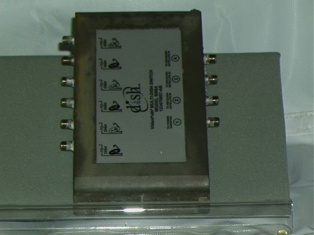

switch
Here are some pics of the Dp 34 sw 44 and sw 64
The twin will not feed an SW44. You would have to change the twin out for two legacy duals and run two additional lines from the dish to the switch. The SW44 needs two lines from each sat location.
