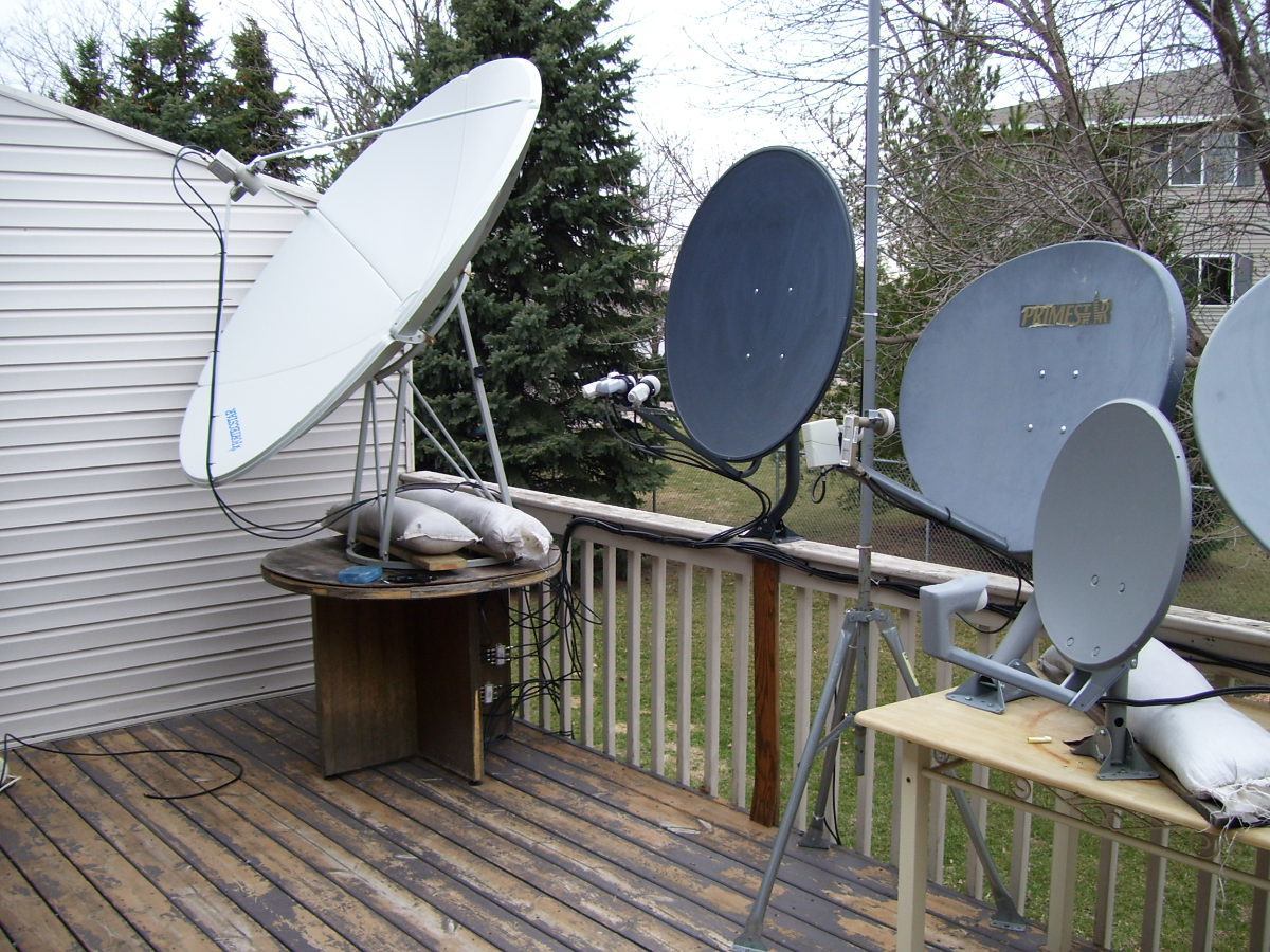

good visual example of a prime focus vs. offset dish
The C-Band dish is at 99 degrees west which for me in Minneapolis is 38 degrees elevation
The dark grey dish is at 97 degrees west so its also at 38 degrees elevation. Look at the way the dish looks. Looks like its almost up and down
Thats why offset dishes clean themselves of snow and the C-Band dish had 6 inches on the bottom of it :)
Thanks for the visual! As mentioned, hell of a garden you have there! Wife would kill me and bury me under one of them :D.
