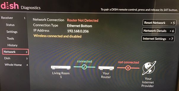

Shortly after, I tried scheduling a recording using the Dish Anywhere app from my iPhone on a cellular connection and got a message "Oops, your recording has not been set because your receiver is not online". Upon arriving home, I checked the internet settings (See Image 1) on the Dish Hopper and it says it was connected to the router successfully, but not connected to the internet. I then reset the network connection on the Dish Hopper and all was well again, it connected right back up.

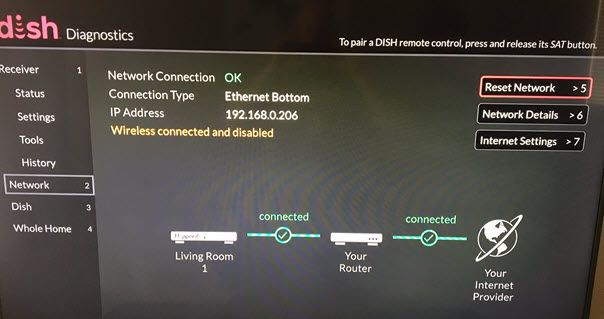

This goes on for months and I cannot figure out why my Dish Hopper "partially" loses internet connectivity within about 15 minutes of resetting the network settings on the Dish Hopper when everything is initially connected ok (See image 2). I have tried hard wiring the unit directly to my router/modem (bypassing everything wireless, Orbi's) with the same result. I tried connecting the Dish Hopper to wireless only without the ethernet cable to the Orbi, same result. Each time it's pulling a correct internal IP address of my network and when it goes into a loss of internet connection, it still has the same IP or sometimes a new internal IP that then works (see both images before and after included here, within 15 minutes apart).
